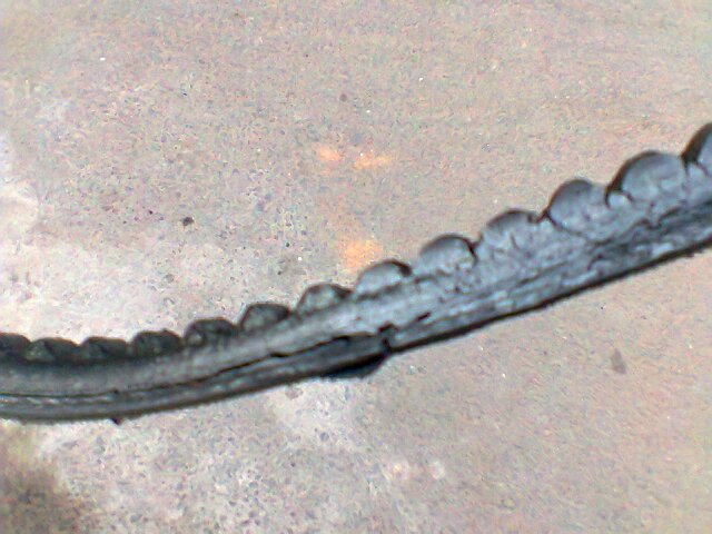

I managed to remove the alternator today, also noticed that the belt had torn in a few places and few deep cracks too. Could this be just a belt related issue? I am open for replacing belt & alternator. As I certainly dont want to repair a 16yr old alternator, replacing seems to be a better solution.

That is called as wrap around headlamp. Or just remove the other one and take it as a sample..
Better change the alternator instead of repairing it..
