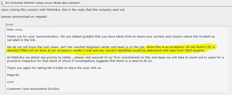

Now learn what Mahindra has to say on the issue.
We do not yet know the root cause, part has reached diagnosis center and team is on the job. Since this is an accessory (ie not factory fit) a detailed FMEA will be done at our accessory vendor’s end and any concern identified would be addressed with help from M&M experts.
At Mahindra we attach top priority to safety , please rest assured of our firm commitment on this and steps we will take to reach out to users for a proactive inspection for that batch of alloys if investigations suggests that there is a need to do so.
Thank you again for taking the trouble to share the post with us.
and I am impressed as of now, not many would have done this in our country.
Nothing new or special, I was well aware of what is written since three days, please have a look at the following attachments(two are from my phone and one from twitter) and please do thoroughly check the dates and time of conversations:
What's my concern is that:
They still have to say that FMEA will be conducted at the vendor's end!
Adding to this no FMEA or FEA on this earth can tell you what the forces are going to do in a thousand or two kilometers of running. C'mon man, I am also having enough experience with these FEA and CFD softwares under my belt. All one is going to get through these analysis is the areas of force concentrations under different force applications as well as where the changes in the design are required. [;)]
Coming to next, my question still remains intact and let me quote it again:
Will Mahindra share it's outcome with anyone or they will simply hide it? If they hide it, then how will anyone come to know if they are safe or not? Indian manufacturers have always been a bit ignorant here and the philosophy of "chalta hai(let it be)" is quite well accepted here. Now who knows if they simply ignore the issue under the blanket that it is okay for regular use?
