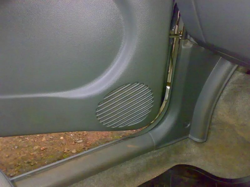

Regarding Front Speakers, I was told that they only 4 inches are able to fit in Zen's front doors hence I opted for infinity series. The shopkeeper was hellbent with Sony & JBL but for the front doors I wanted little bit premium hence I opted for JBL's Infinity series. I have heard that Hertz and Focal are good but they are very costly. If they are they in 4-5k range I would definitely give them a chance.

4" speaker size is a limitation. You will not get components except Kicker ES4 but you can go for a coaxial, no need for tweeters with coaxials. Infinity is also good.

Front Speakers: I guess I need to chose those whose which actually doesn't require tweeters. I have read its advisable to put components in the front and coaxials at the back.somewhere around 150 RMS would be decent enough.

Front Speakers -
See, there are 2 types we are talking about. Coaxials and components. Coaxials have an inbuilt tweeter and don't need additional tweeters (it will result in sharp sound if done) while components come with a seperate tweeter as a package. Components give better sound because of seperate drivers to handle different frquencies. But they are available in 6-6.5" sizes mainly and only Kicker ES4 comes in 4" I think. For coaxials, you have a better choice like Polk 541 (not sure if this is the correct model no.) and variety in 4" also. RMS of the speakers isn't much important in case you are adding an amplifier as utlimately the amplifier will power the speakers and it makes around 60-75w RMS.

Front Speakers: Then I will definitely go with the component speakers because the car will be self driven most of the times and I want driver to experience best highs possible. I can always get tweeters drilled in the doors or mounted on the front frame. Now the components has been decided need to decide which brand to chose? I haven't seen Polk or Hertz installed in any car.

One other thing you can try to maintain stock look is -
Get a box made by your installer to accomodate 6.5" component, which is like a table (4 legs, 1 top with 6.5" hole) and place it below your front seats with components. That would be the best choice though a bit awkward as sound will come front below as compared to side. You can also try a reverse |_| arrangement which will not move around much. Make sure the box has 2 sides open for air passage.
Doorpad provision looks 4" only, no need to check.
All woofer boxes are efficient as long as internal volume remains the same. Square boxes are easy to make as internal volume calculation is easier (multiply all sides). So you can go with a square one.
470SF has higher RMS than all others. RMS is more important as it means you amplifier can give that much output always (minimum) while max power will be seen (or used) only when you turn the volume to extreme levels. So, higher RMS is more expensive than higher Max power. I have Pioneer amplifier with 1000w Max, but 500w RMS - costs around 3 times the 470SF.
I hope I answered all your doubts.

Hmm.. Interesting way to put front components.. But won't I be getting muffled sound by this set up? Where would I be facing the component towards the seat or towards the dashboard? I'll do one thing.. I'll go and check out the market out today.. Chandigarh doesn't have that much variety n innovation but I'll try if they can do this set up.

Yes the sound will be bit muffled but main difference would be in the feel of sound. Sound will be coming from below the seat instead of near your legs, that is it. I don't think this is a bad idea as difference in output of 6.5" components and 4" coaxials is H U G E. Since you are getting components, most high notes of audio will sound normal i.e. from dashboard tweeters but mid-bass notes will be slightly different that conventional arrangement. No big deal as people even have under seat woofers and are happy with them. Idea is very simple, talk to your MDF fabricator for building the box. It is like removing the base and any 2 opposite sides of the subwoofer box.

I asked him what are the alternatives for the front door speakers of Zen? I asked would 6 inch components be able to fit? He bluntly said why not, to which I replied how? And I additionally said that I don't want any cutting shutting. He said some thing like "Sir, nayi jaali lag jayegi Kuch kaatne ki zarurat Nani padegi" I didn't understand this part. He said when I will bring the car he will show me. I asked at what price. He said it will be free or cost will be included in the components.
I asked the same thing from 2-3 shops who were working on audis n beemers.. All said same thing.. No need of cutting.. Jaali lag jayegi and magnet door ok bhi nahi touch karegi. I wonder how will they do that?
