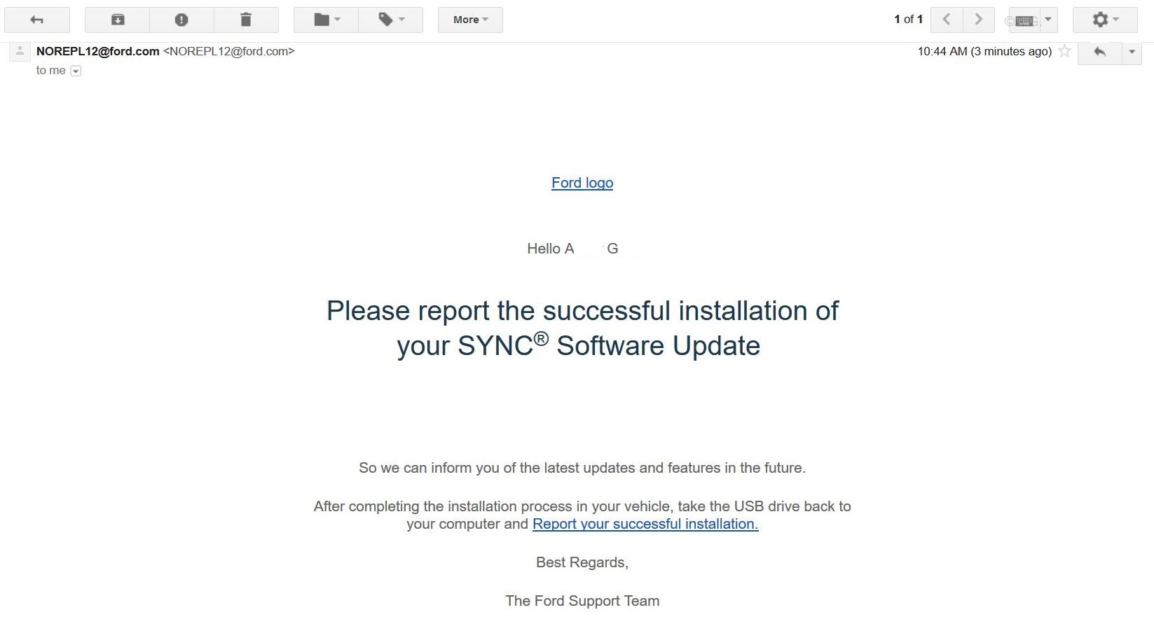

Step 4: Depending on the load on the server, the email with directions to return to update page with embedded link in the text SYNC Software Update would be received. In my case, the email was received in a couple of minutes. Clicking on the link embedded text would take you to the pop-up with info on downloading the package where clicking on OK and then Start Download would start the download. The last pop-up also lists to have a FAT32 formatted 8GB or more pen drive ready. The package itself could be a large file and might take time in download. In my case, the package size was 3.2 GB. Soon after the download starts, an email would be received to report successful installation of SYNC Software update. More on this later.

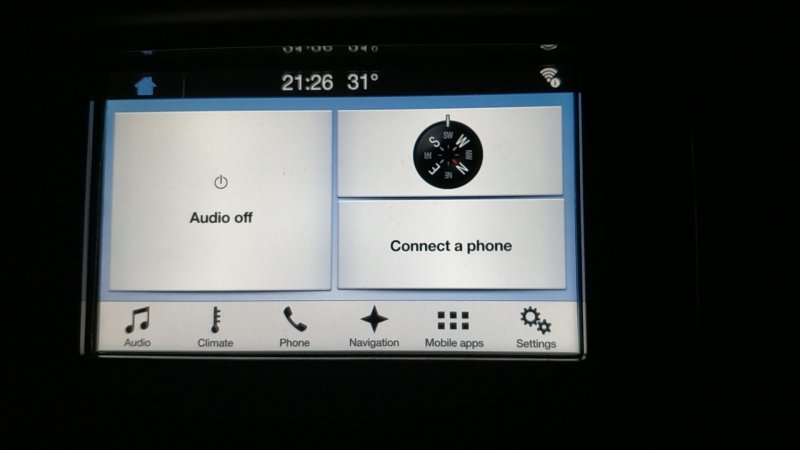

21:26 – Ignition turned ON after inserting pen drive
Step 7: After waiting for a couple of minutes, the contents of the pen drive were recognised by the SYNC3 system and it displayed Updating system software.
21:28 – Updating system software

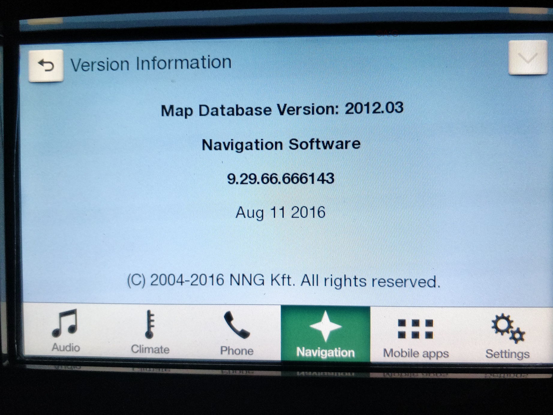

Sharing the version info
SYNC3 info (Before)
SYNC3 info (After)
Navigation info (Before)
Navigation info (After)

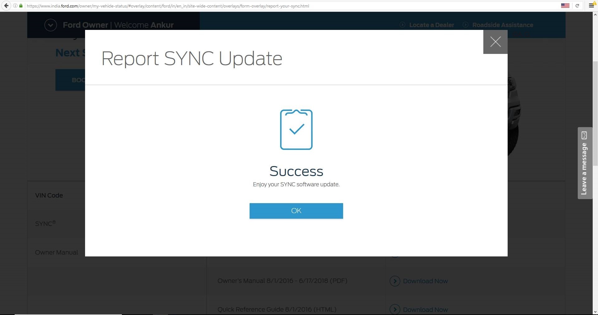

Step 10: As reported in Step 4, the email asking to report successful update would be received. Click on the link embedded text to Report your successful installation. This would take you to a page with pop-up asking the same.
Step 11: Clicking on Report Installation opens a new page to browse the file. Plug-in the pen drive used for update and then click on Browse. Select the last modified file from the SyncMyRide folder. Time of this file would coincide with the time when the update successful message was displayed on SYNC3.
Step 12: With the file selected, clicking on Report Installation would inform the status of reporting.
