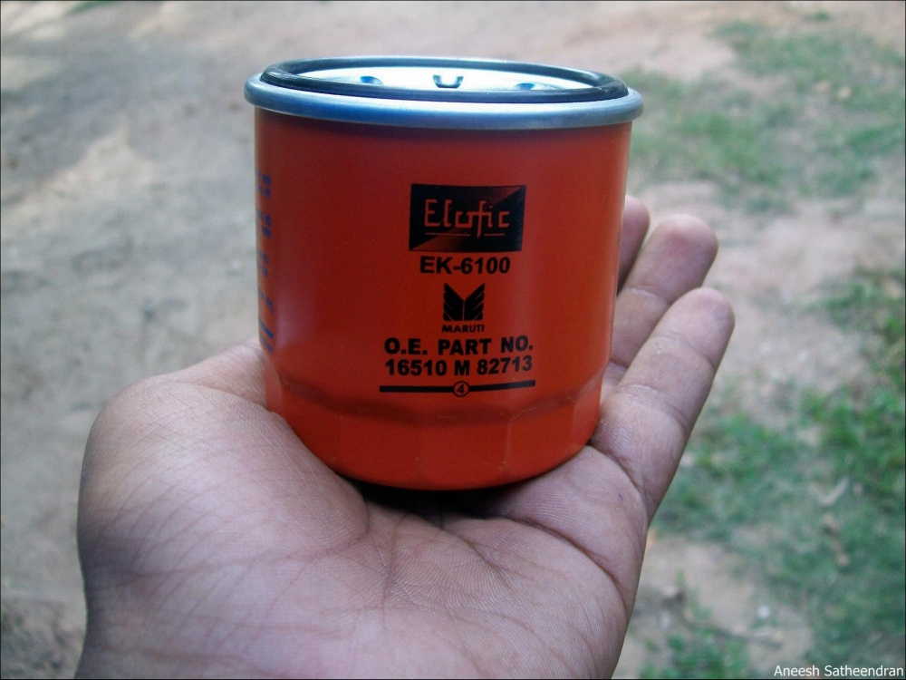

  1. Engine Oil [3 Litres],Bought Shell OEM 20W40 Oil~ 770RS
  2. Oil Filter~ OEM~80RS

5.Remove existing oil filter using Oil Filter Tool.While removing the filter,oil will come out,so place a container under it to prevent it from falling on to the ground.
6.Clean that oil filter area using a cloth.
7.Put new oil in the filter's o ring,Fix it in place.Tight it using the tool or even your hands can do it,Never over tight.

Changed 2-3 days back for Estilo, slipped jack and broke the bucket [frustration]
Oh, the orange one was OEM. I thought it was some crap stuff used by them and was cursing them. Last time they used Mico Bosch itself. What I bought this time was also Mico Bosch.
Yeah,its the oem one,Bought this for the 1st oil change too.:) Any suggestions? :)
