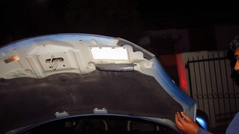

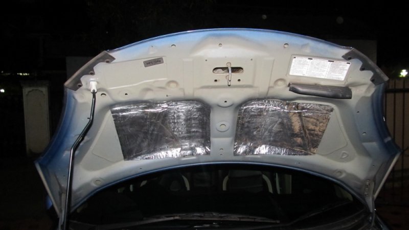

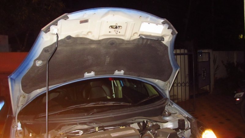

DIY Hood Damping

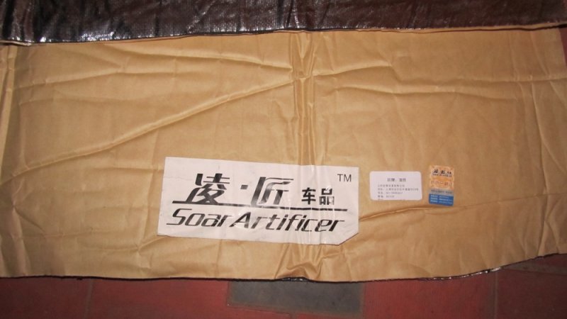

Soar Artificer, a Chinese brand Damp mat's Bought from eBay
Ready to be damped

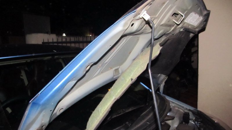

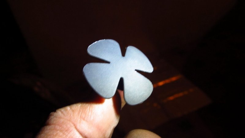

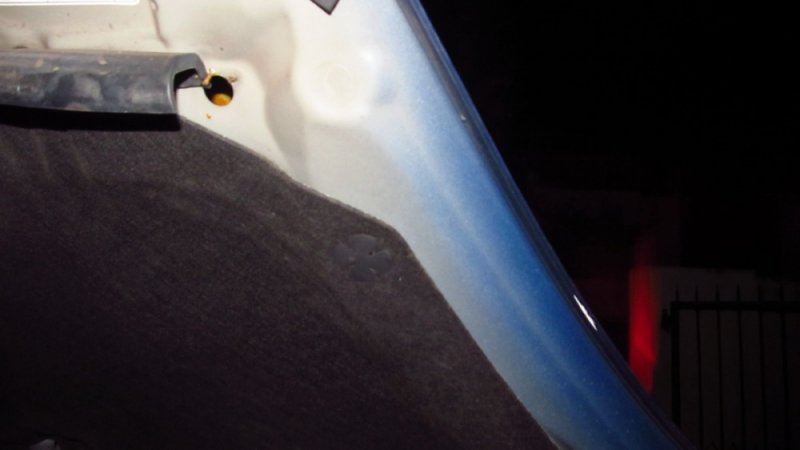

Remove all the clips

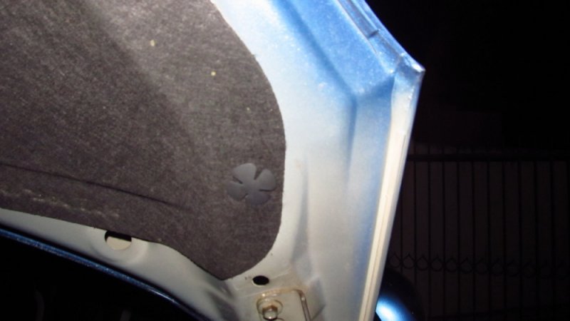

Close view of the Clip
Another close up:tongue:

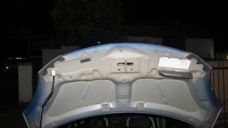

Detach the factory Damping material
Clean the area using cotton waste

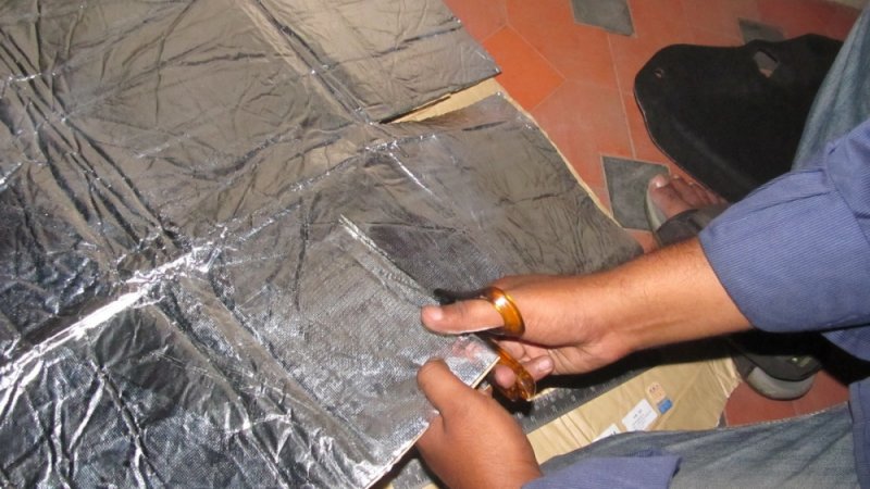

Soar Artificer Damp Mats

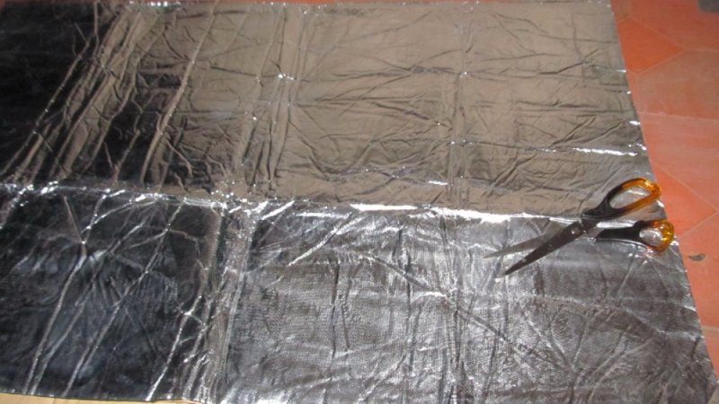

Since it was a large sheet of damp mat, cut down according to your requirement
Cut out piece

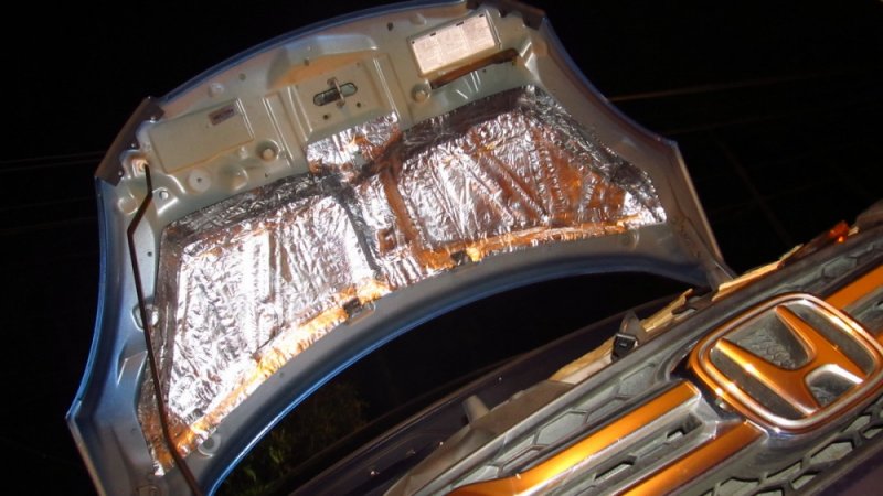

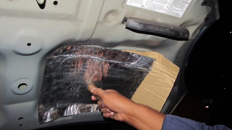

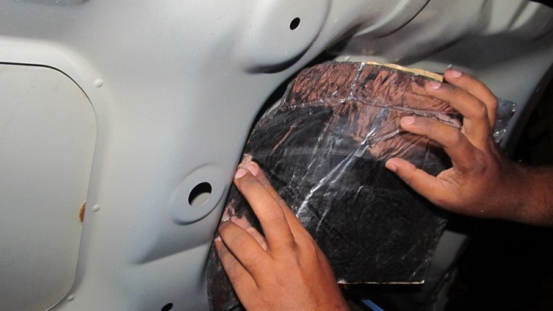

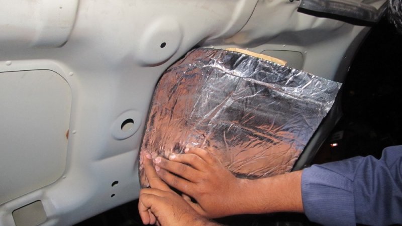

Sticking on the hood
Custom Rollers to the rescue:biggrin:

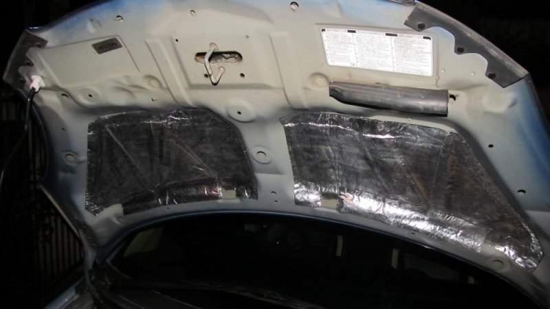

Do like the same for every place to be damped

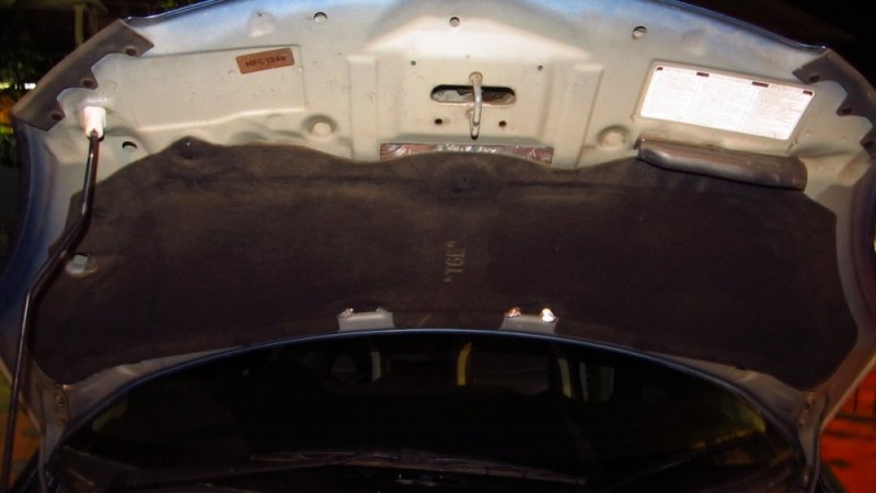

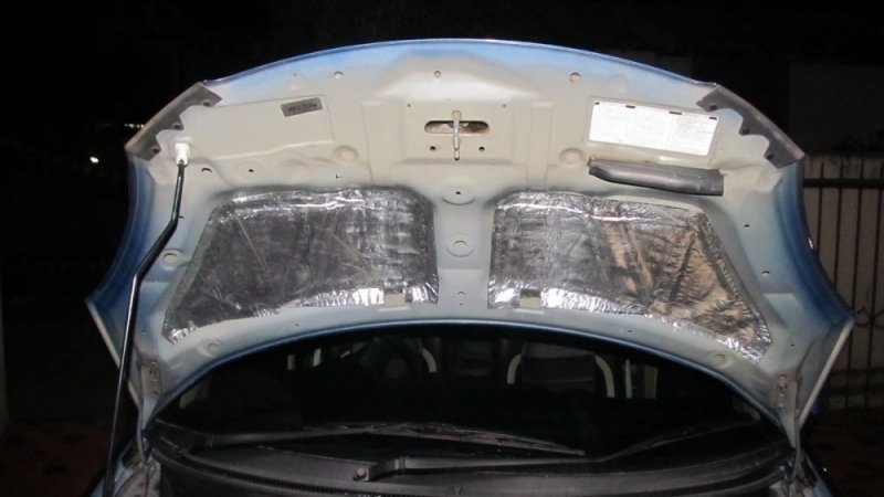

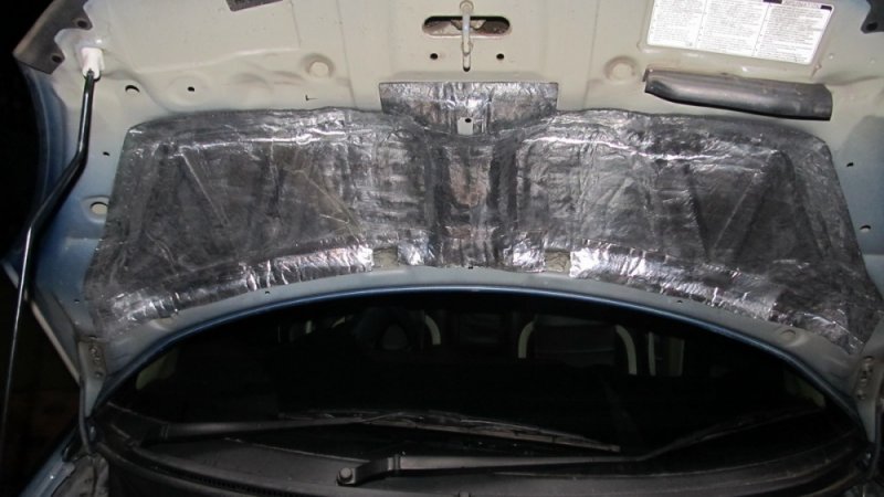

Finally a fully Damped Hood:cool:
Place Back the OEM Damping and put back the clips
