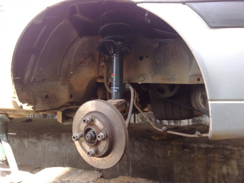

1) Suspension Change - New Gabriel Struts at Front & Rear
Front Struts - Rs.3750
Rear Struts - Rs.3500
Strut Mounting - Rs.400 each (Total of 4)
Mounting Kit - Rs.850 each (2 sets)

here are few pics, which I managed to click at the workshop:

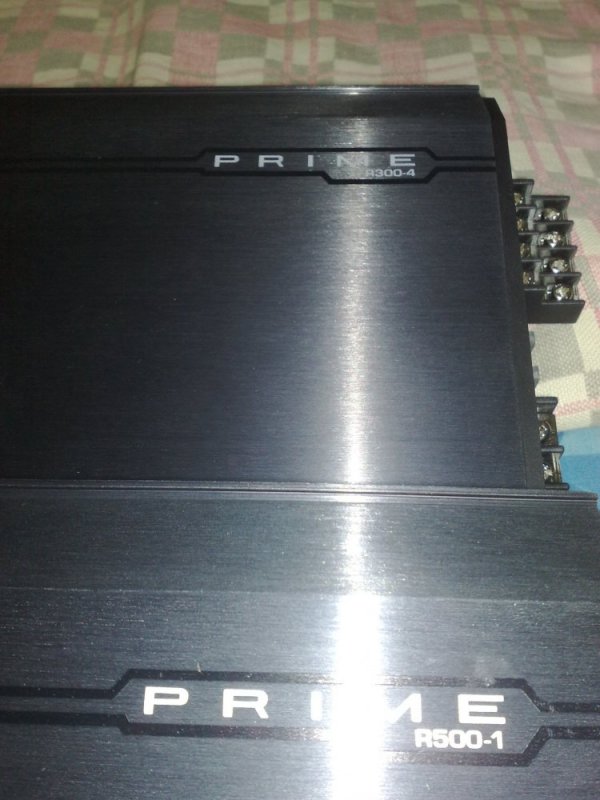

was waiting at the arrival for more than an hour and then she shows up with my long expected goodies. Here they go:
1) Alpine CDA-117 CD Receiver
2) Rockford Fosgate R300-4 Four Channel Amplifier
3) Rockford Fosgate R500-1 Monoblock Amplifier
(also with these a pack full of snickers have arrived[evil])
Now that, one half of ICE is ready, I ll have to arrange money for the other half which is still pending Front & Rear Components/Woofer/Wiring Kit.
Spent all the money I had on service[frustration].
Please help me God!!!
Meanwhile, few pictures of the player/amplifiers for you:
