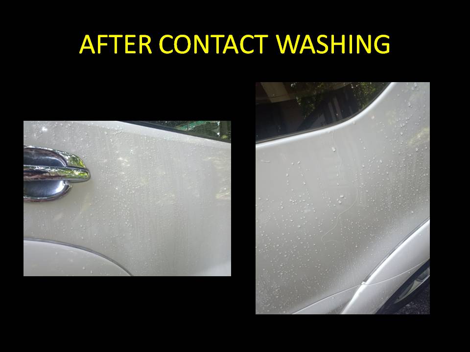

After this i used snow foam to cover the car in shampoo suds and did the routine contact wash to finish of the process .
you can see the water beading effect still persistent which indicated that the iron remover solution does not affect the paint protection /sealant drastically
