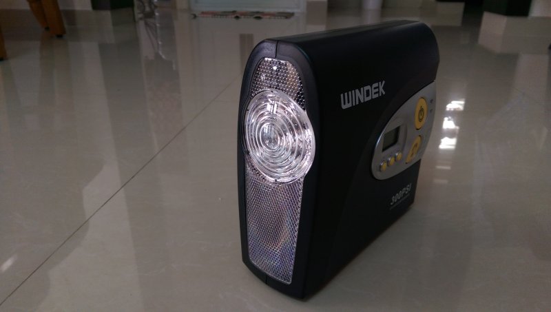

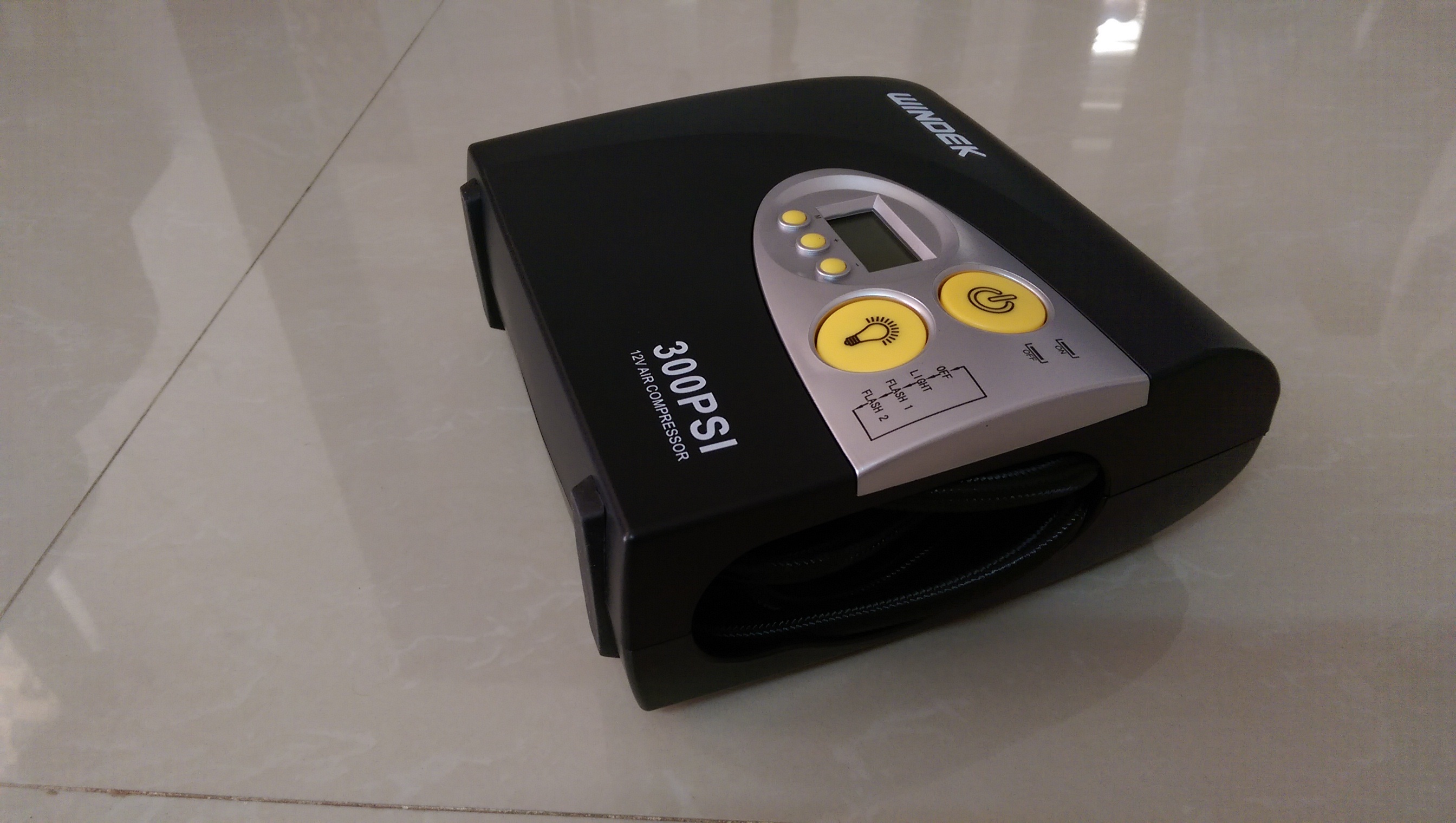

The Inflator:

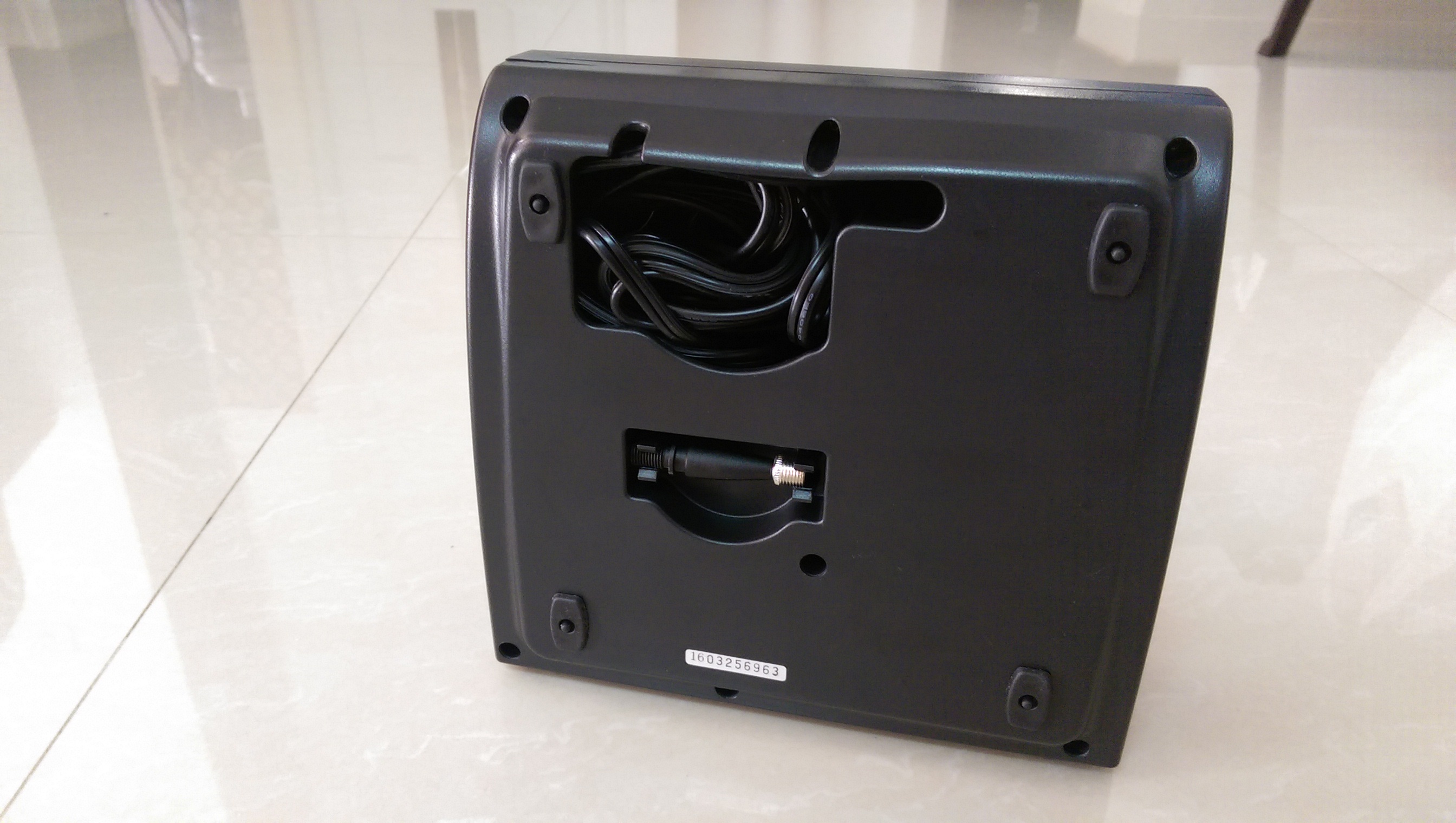

Power cable neatly tucked in:
Useful flashlight:

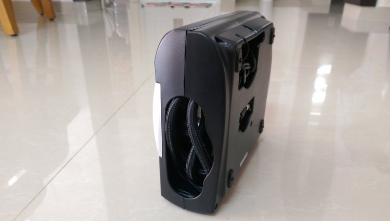

Air pipe tucked in to the side:
About 2 feet long & has nylon coating:
