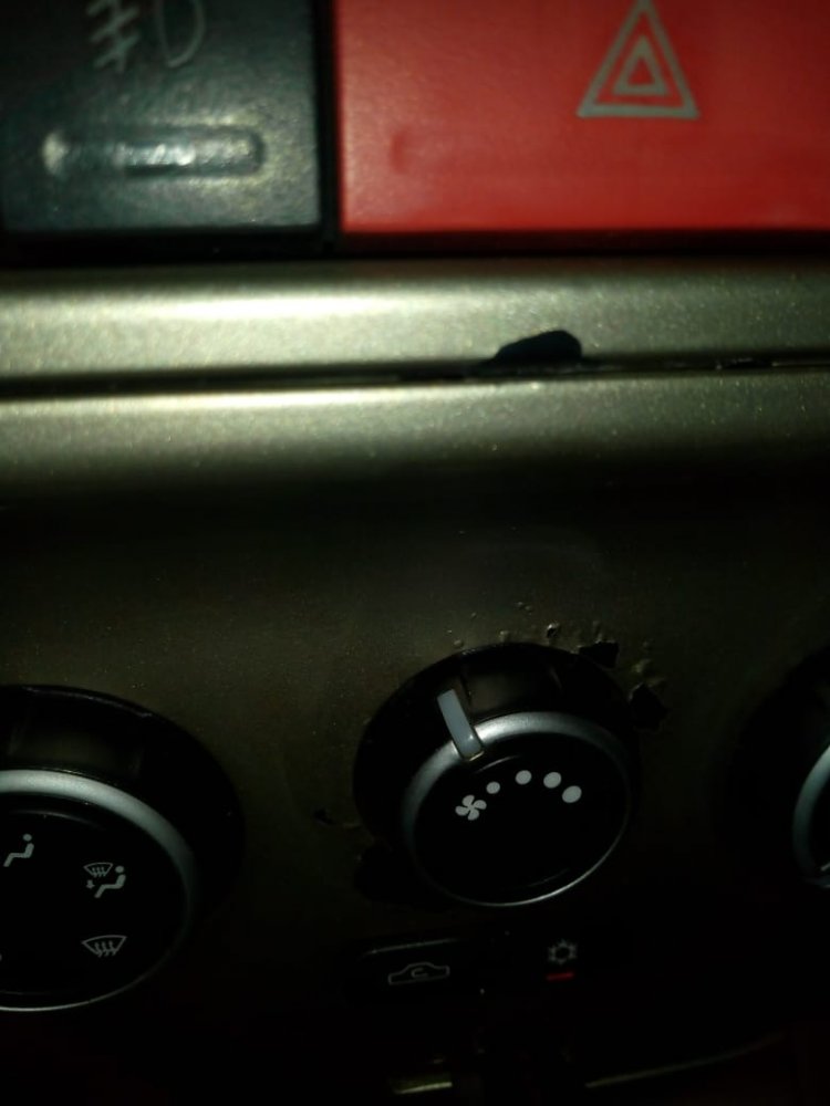

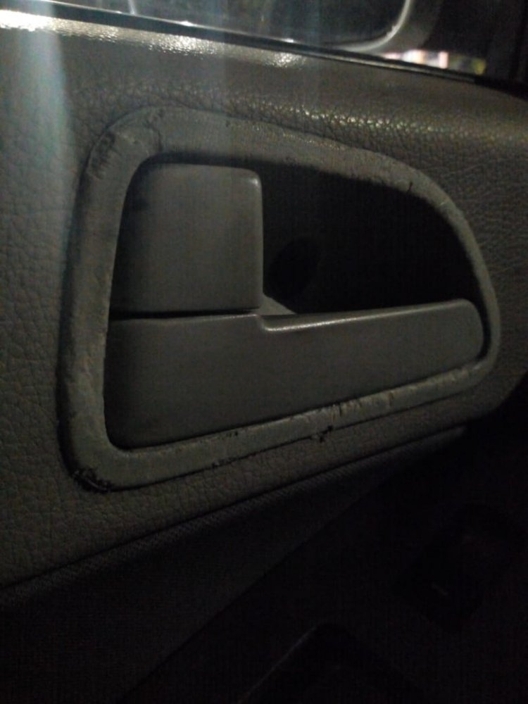

1. The headlight glass colour has started fading away.
2. The dashboard's middle area's paint had also started coming out like peel. I'm talking about the area where there are AC controls.
3. Do all diesel cars take 2-3 ignitions to start?? Because if i try to start my manza on single it just keeps on cranking.
4. Are remaps available for my manza under 10k-15k ??
Experts advice needed!!
1. If the fading is minor and just outside, you can buff it at 3M guys. BTW is glass is yellow/dull due to age/ High watt bulbs, It cannot be buffed.
2. Guess the car is asking you for a custom Paint or Wrap/ Chrome treatment. See my Painted Safari Gear lever, Park brake and Steering for reference.
3. Thats not normal. As @vishnucrazy mentioned, it looks like a fueling issue.
Check simple things first. Like Fuel filter, Air in fuel Lines, Dirt in fuel tank etc.
Then move on to check Injector Wiring and fuel Supply.
As the Injector was opened recently, was it fitted back properly?
Then check HP fuel pump, ECU wiring, Glow plug wiring, etc.
