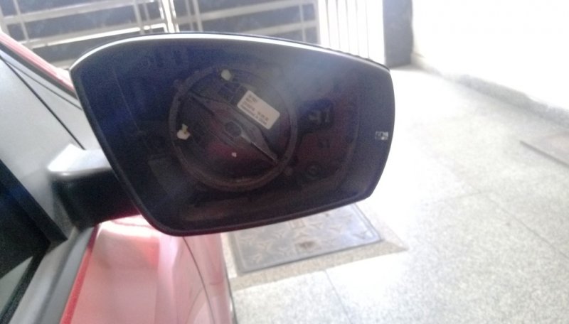

Did a small diy project to the car. Changed the ovrm mirrors to auto dimming ones.
housing after taking out the original mirror
used a prying tool. ordered the prying tool kit from aliexpress. quite useful indeed for various diy's.
carefully pryed open the mirror

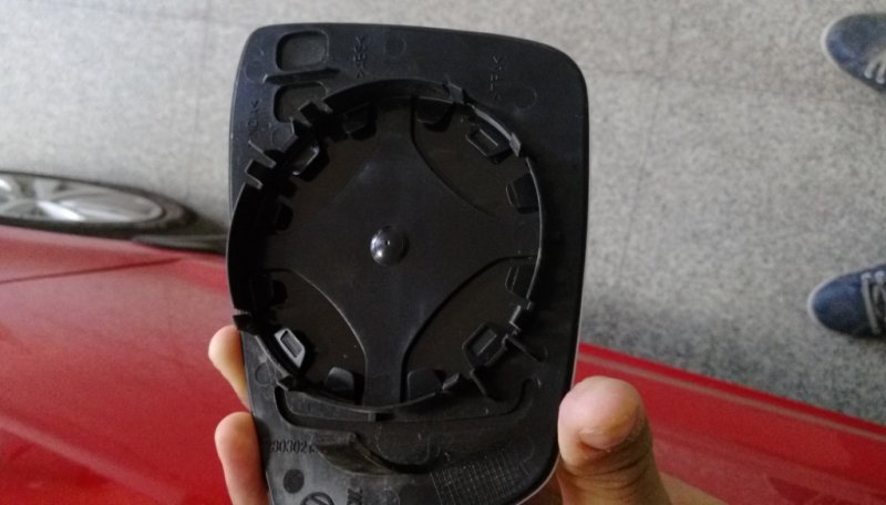

back side of the stock mirror
gently pushed the new mirror back into the housing so that it locked with the plastic locks provided in the housing to hold the mirror.

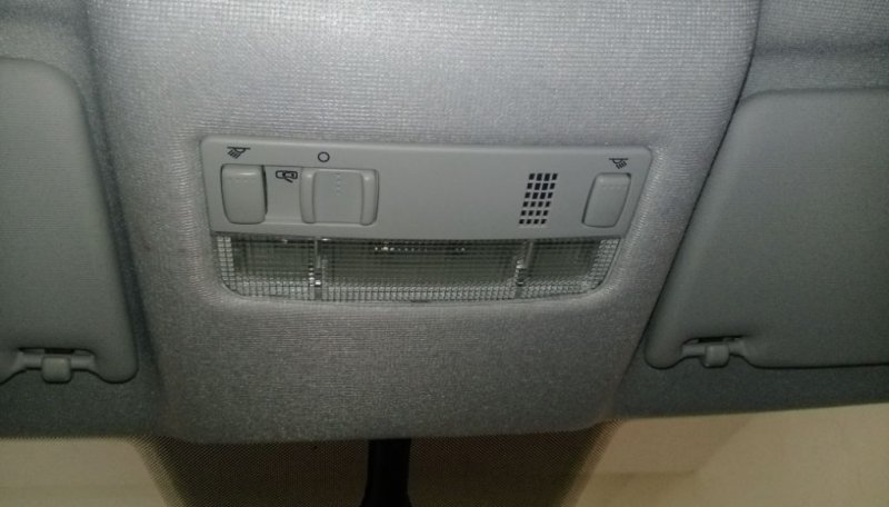

Also added cabin light with individual lights for driver and front passenger.

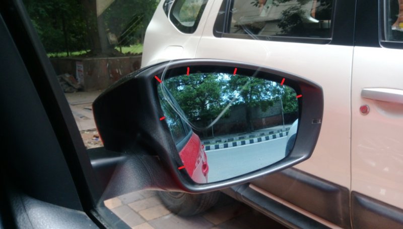

The ovrm mirrors are good and the auto dimming feature works well and is definitely helpful during night drives. The mirror is slightly smaller than the housing in my case but not a deal breaker for me. Following pic will give you an idea. I have marked the differnce in the size of the mirror with respect to the housing.
The size would be worth trading for the convenience of night driving. Appreciate the info though.
