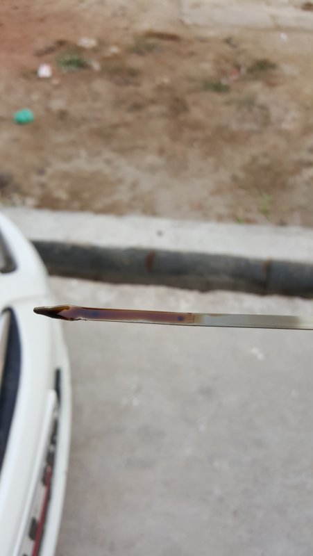

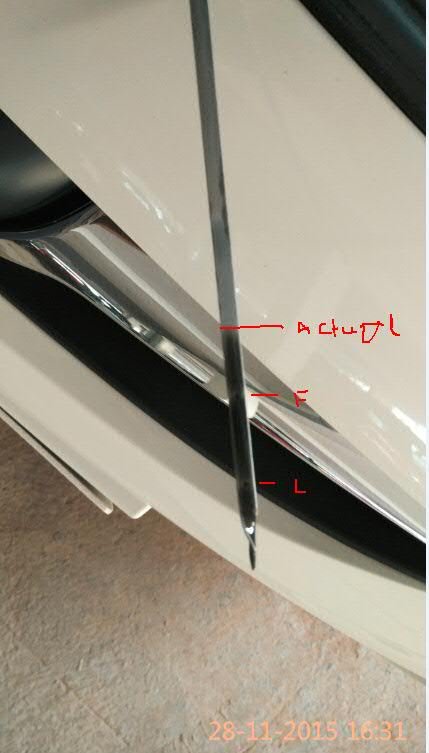

Update:
Day before yesterday, I thought checking the engine oil level to check if excess oil could be the culprit for the mild vibration. To my surprise it was more than it supposed to be. Took the car to ASS, Trident Hyundai, Kalyan Nagar yesterday.
The ASS guy checked it and said it's normal and not too much. Also he said, if car is not started for few hours and we check engine oil level, it will show more than required. He took a test drive and said he is not able to find anything wrong. Then he called two more mechanics, they too checked the engine oil and said it's fine with the level. I also checked another diesel Verna, it also had same engine oil level. They also did a scan on my car and found no issue. Also the mechanic did a TD on my car and said it's fine and smooth.
Then I asked ASS to provide me another Verna to do a TD. I drove the other Verna , but really didn't feel the same vibration it is in my car between 1200~1500 rpm.
I told them , in future if any engine damage happens and then they have to deal with it.
Came back home with no conclusion. I think I have to live with it. ASS guy and mechanics were well behaved and tried to check the situations as far as possible.
