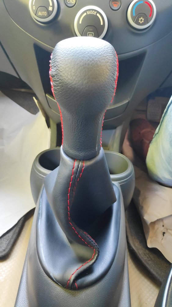

Custom Made Gear Knob
Finally got some time to do the leather wrapping work of the gear knob and installation of the custom made boot.
Work was done on a friendly neighborhood car accessories shop. Total Cost: 1050!
They have done an excellent job. I really like the looks!

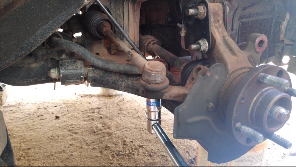

Step 6: Remove Tie rod end
If the tie rod end is stuck in steering knuckle, insert the nut back and hit it with a hammer.(Be careful, do not damage the nut and ball joint)

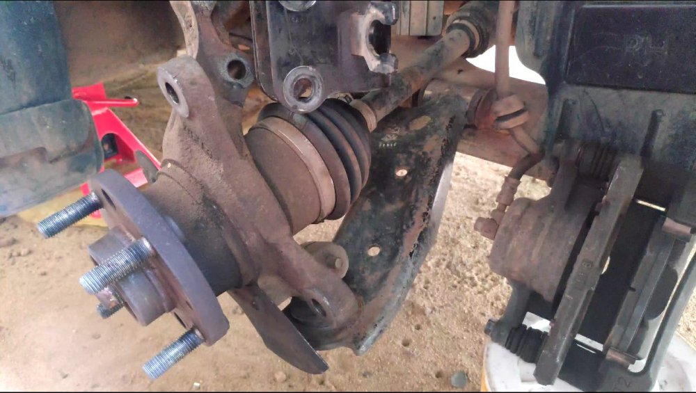

After steering knuckle removed!

Steering knuckle
Steering knuckle with new bearing
Steering Knuckle after replacing bearing (I painted the knuckle to prevent future rusting).
Old damaged bearing.

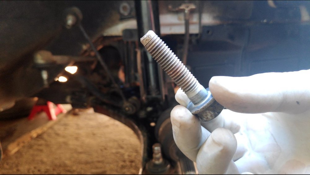

Before installing the bolts back, clean the threads with a metal wire brush.

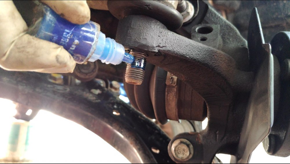

Apply little bit of thread locker to the threads of every bolts and tighten them.
