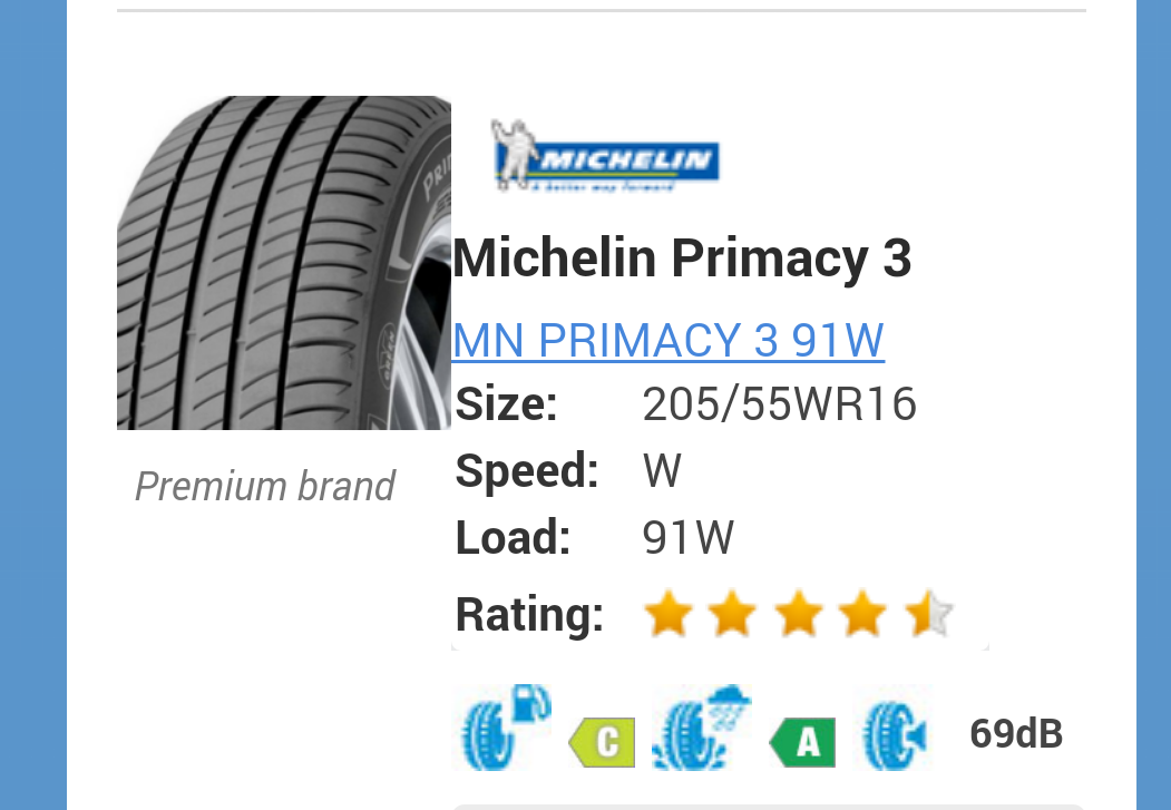

Michelin PST :
Tread patern: Asymmetrical, (meaning good for hard cornering) & non directional.
Ply composition :
Tread : 2 steel + 2 polyester + 1 polyamide (polyamide gives better ride comfort) I wish, it was with 2 layers of polyamide, making it most resistant tyre against tread bulge/burst )
Sidewalls : 2 Polyester.
UTQG rating :
Treadwear : 340 (best amongst the other tyres in consideration)
Traction : AA.
Temperature tolerance : A
ECE markings : 'E2'mark present, registered at France under amendment 2 of the ECE regulations. ( no mention of S & W marks) This is probably due to introduction of EU label system by the EU and primacy ST got launched at the same time.
EU label :
fuel economy: C (one of the best amongt the others)
Wet grip.: A(Best amongst the others)
Noise : 69 dB.(one of the best)
Cheapest qoute : 7400 per tyre including fitting alignment balancing.
