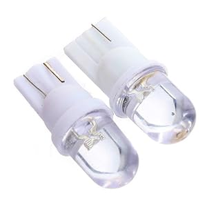

License plate lights to White LEDs. Can anyone tell me the types of bulbs because there is no way for me to check since the car is back home in Kerala.
For number plate you can use these type of LEDs. I have also used them in my Honda City. I had normal OEM yellow bulbs and changed it to Red with these type of bulbs. I bought a pair for 250/- from Bombay. Also try buying them online.

Changing license plate lights is okay. Go for a warm white colour, it would look better. There are many designs available in T10 holder shape. There are projector ones (LEDs which project the light to a direction and look brighter), SMD ones (one single piece of SMD LED illuminates, brighter and more power efficient) and LED ones (which have a set of LEDs, better for spreading illumination). Cost would be higher online (due to shipping and other charges), better is to get them from shops. I got 2 Projector type for Rs. 50 from Delhi. They normally don't get kaput and in most cases, a loose fitting results in problems.
