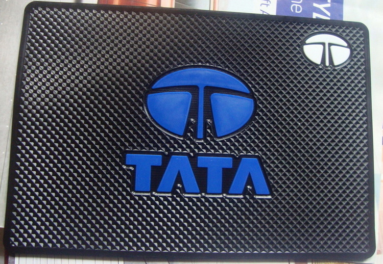

Last week I bought an anti slip PVC pad for dashboard. It comes in black colour good firm grip and can hold cell phones, sunglasses, keys and miscellaneous small items. It properly fits on the centre of the dashboard where there is a small deep area which seems made for this accessory.
Backside of the pad is very shiny (black). Looks like it weighs around 50/60gms. Price Rs.245 all inclusive.
Mat dimension: 18.5X12.5X1.5 cm (actual)
Kept my smartphone on top of it and took the car for small drive.. Applied sudden brakes and sharp left/right turn, etc. but the phone did not move at all from the pad.
Back side of the pad
Centre of the Dashboard where the pad has to be placed
The pad fits perfectly in that space​
This is how the seller describes the product: This Imported Non Slip, Anti Slip, Anti Skid Mats/ Pad has been exclusively designed to be placed on your Car Dashboard helps you keep your mobile safe on the dashboard or anywhere in the car while you are driving. It keeps your phone from slipping anywhere and it's texture enhances your car's interior.

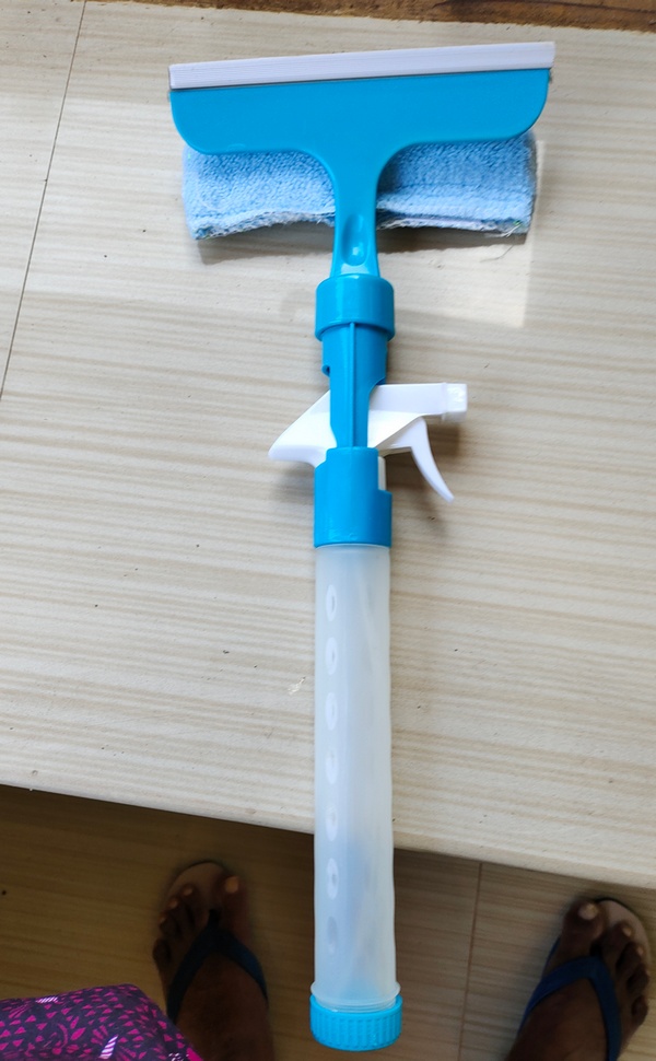

Just got delivered another item - Glass Wiper Car Window Cleaner
3 In 1 Window Glass Cleaner Wiper Scraper Brush Cleaning Tools. I have not yet used it but looks good for emergency (during long drive) cleaning of the windshield. Have seen others using it, hence decided to buy one.
What they claim:
1. Gentle and delicate scratching will not hurt the surface.
2. Ergonomically comfortable design for easy operation
3. Multi-functional window glass cleaner brush, one-piece design.
4. With spray, scrape, brush three major functions. The nozzle can be adjusted in three positions and used up to you.
5. Can spray or direct spray, easy to use
6. Microfiber towel cloth headgear, soft material, will not scratch the surface of the object. Special glass cleaner, tile cleaner, spray design
  • Handle length: 31.5 cm
  • Handle diameter: 4 cm
  • Brush width: 15.5 cm
  • Width scraper: 13.2 cm
  • Weight: 215 gm
Specification:
  • Multi-purpose: It can be used for cleaning glass, walls, car, floor, and bath crock. It is also suitable for all kinds of glasses.
  • 3 in 1 tool: It contains a water spray, a cleaning sponge, and a cleaning squeegee. It makes cleaning stains a lot easier.
  • Practical and durable: It’s a great cleaning tool that fits the house, hotel, and cleaning service.
Link

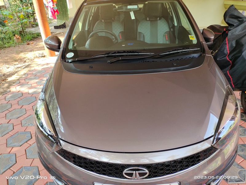

It's time for the next major service (Paid). I took the car to the Tata service centre in my locality (they have now opened a service centre just 2.5kms away from home which is very convenient for me to do the job - previously I need to travel around 45kms -one way- for any kind of job). Reached the service centre at 9:45Am (time slot given by them was 10:10am) and shown the car to them.
The last service done was on 18th June 2020. Only about 2000kms done after that service and thereafter repeated covid lockdown etc., I did not take the car for any service so far. The SA looked at his computer and found that the car was not serviced for almost 3 years and immediately advised that need a Major Service which would work out to Rs.10000/-
The shining of the body was looking dim (did not do any polishing since purchase/delivery), and SA proposed Teflon coating which costs Rs.4250 (normal waxing/polishing Rs.3000). I agreed to do the Teflon coating on all over the body.
The shark antenna which was purchased online and fitted on my car started loosening hence I requested them to replace it with original antenna which I kept in the Glove box.Initially the SA said that if we remove the shark antenna then there will be some stain (marking of the sticker used to fit the shark antenna) around that area, but when I agreed to do the Teflon coating, they agreed to do refit the original antenna
The broken shark antenna purchased online​
They took the full day and finally delivered the car to me at 5:45Pm. After the service the Car really looked shiny and I felt lot of changes while driving back home. I drove the car around 40kms yesterday and I felt it very smooth / quick AC cooling even after parking the car under the sun for more than 90minutes.
The total bill for this service came to Rs.12, 792/- inclusive of all taxes. The break up of the expenses alongwith list of services carried out are given below:

Couple pictures taken just now (service done on 20th May):
Tigor original Antenna re-insallted
