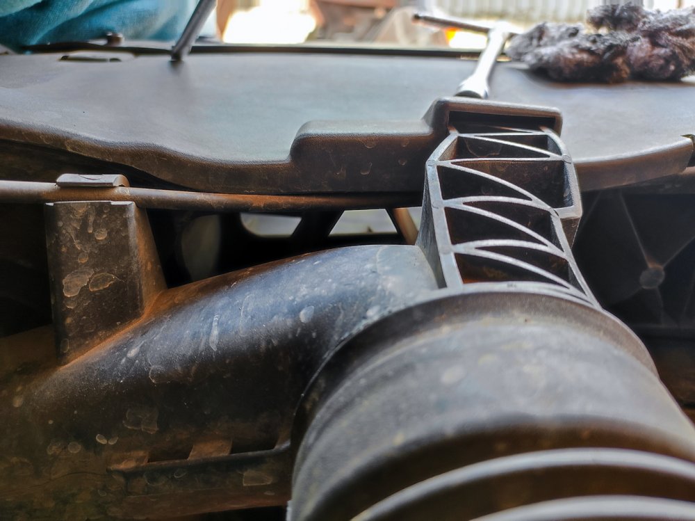

@mayankdixit Routing of air intake. Starts from the rear side of the headlight and take a right and left to reach the filter box.
The hole behind the grill is just dummy.

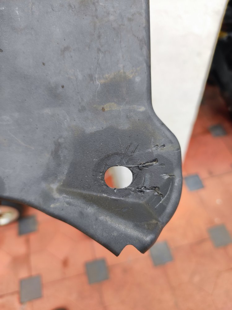

How cruel the last service guys were. Bolt driven too deep, deforming the bumper.
