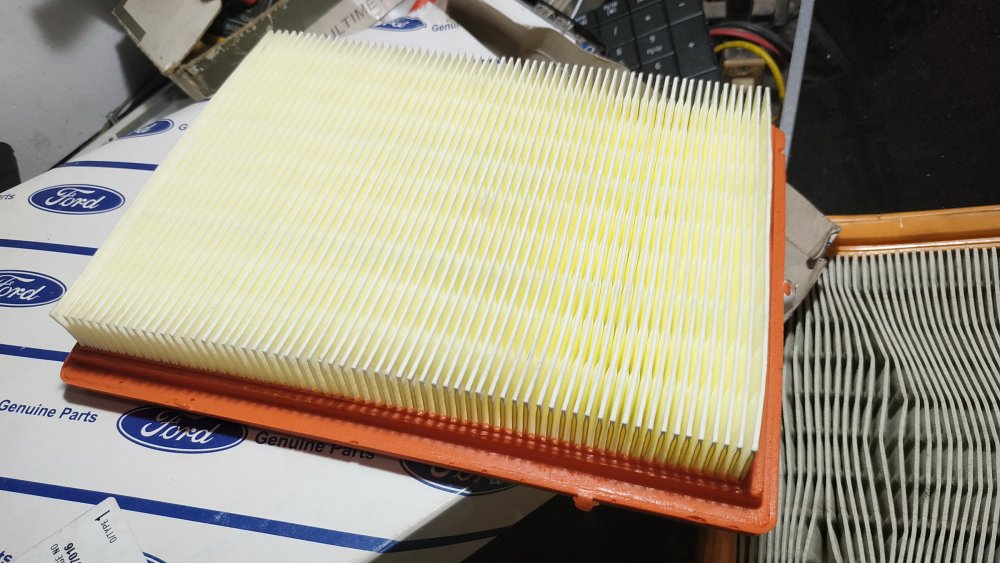

Old Opel filter installed by the stupid garage. See how bad it is with deformed pleats trying to squeeze into where it didn't belong to.
Dimension comparison. Clearly shows how "effective" the filter was and self-explanatory why the throttle body got clogged and the car was doomed.

New filter in. A strip of glue holds the pleats in place.

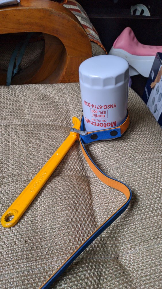

Bought a generic belt wrench for oil filter. DIY this time. Got from Karthik Hardwares in Powerhouse Road, the shop from where I bought my first wrench some 10-12 years back. Tried most of the cup wrenches available there and none suited the Ford filter. Picked the belt wrench instead. It was like ₹200 or something. Suits 40-160 mm diameter.

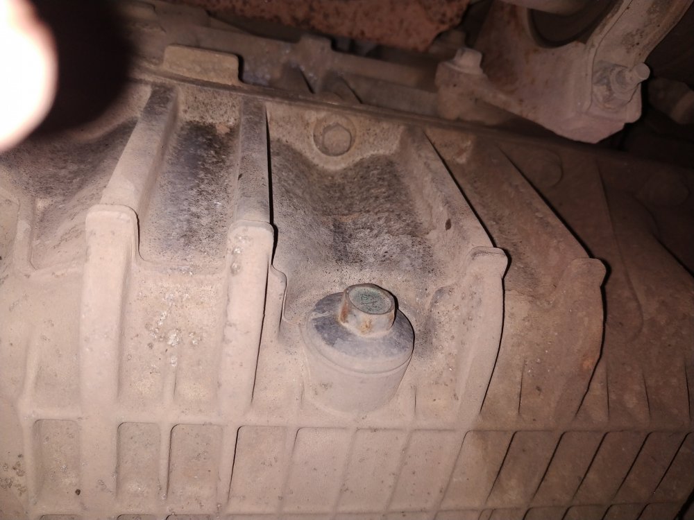

Drain bolt. Sits behind the sump.

Drain bolt was 13 mm. As expected, it was super tight and not budging a bit and head starts deforming. Stopped it then and there and declared it another screw up by the stupid garage.
Took it to our Chevy guy, and he said he would try and in the worst case scenario have to cut it open. So, have to procure new drain bolt before giving it to him.
