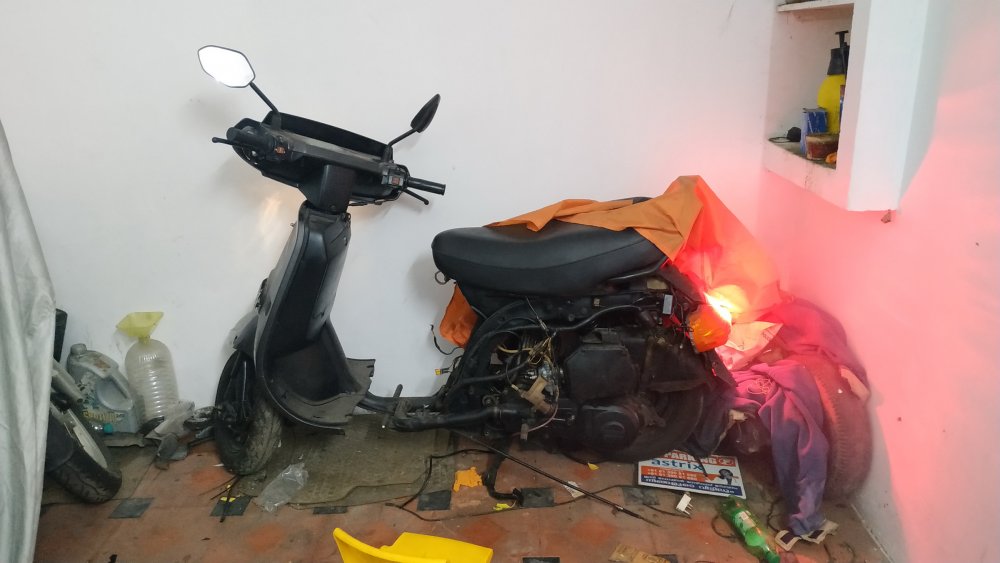

Stock wiring was short in length and wouldn't reach the new location since it was designed for stock Keihin, which sat on the carb. Hung the auto choke temporarily. Kiney started in single kick. Adjusted the auto-choke cable. All is well.
(Actually there was no need for a choke, but choke valve need to be set a bit above full closed position for working).
Now the big headache being finding the parts I removed from Kiney aka body panels and all the nuts and bolts and misc parts. All stored properly, but places changed by mom every time she rearranges or clean home.

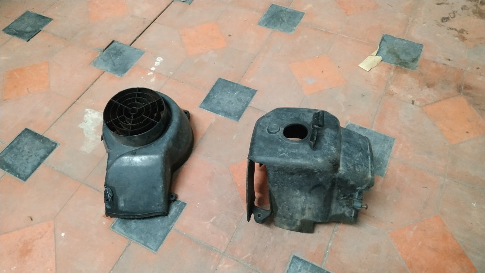

Found some of the parts and the parts bin.
