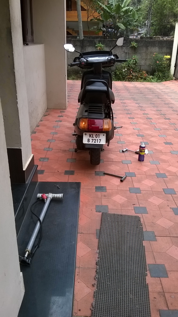

Kiney was giving some hiccups like misfire for somedays. Was pending the job as I was busy and it was clocking barely 100 km max a month. Was sure it was damn plugs. One lazy morning opened it.
spark plug socket for 1/2-inch drive. Paid 125.
It can also double as 21-mm socket
To my shock I was running on a MICO Bosch plug after the engine overhaul, which I was not aware of, but as expected it was clogged plug. Gonna put new G-Power next month itself.
Cleaned with WD40 and sand paper.
WD40 now available in made for India jumbo pack. Very economical, just 280 bucks.
Socket comes very handy. Before, I had to removed whole body and even exhaust to get proper access to plug. Right tool always saves time and effort.
