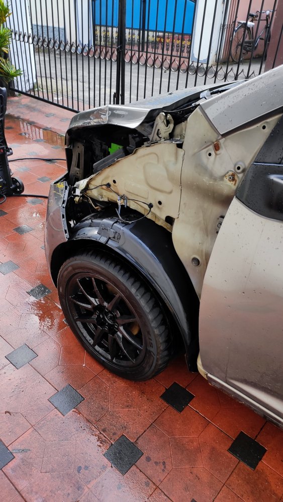

The Incident – Brother took the Skids and caught up in a pile up. As usual, the catalyst was an auto, who decided to take a hard left without any warning. Pickup behind him panic braked, Beat swerved to avoid, but hit the corner and an RX100 hit from behind. While pulling over, the auto and bike guys escaped. A police patrol came by and stopped. They took photos and took a brief of the incident. Accompanied them to the Police Station and asked for the proceedings. Didn't have the registration number of other two parties, so nothing could be done from their side to catch them. Had to make GD entry for insurance claim. The system has changed, and we have to do it ourselves online via their portal and have to collect the report once approved after investigation. The whole thing wound take around 10 days. Car was in running condition, so asked him to bring it home and go to Akshaya to file for GD. While at home, he broke the antenna in panic while parking.
Headlight and fender took the major hit, while the hood had a minor hit. Headlight covered the major part of the three-quarter, making it look like heavy damage.

Removed the fender when I got bored waiting for the lights.
Pulled the bumper out.

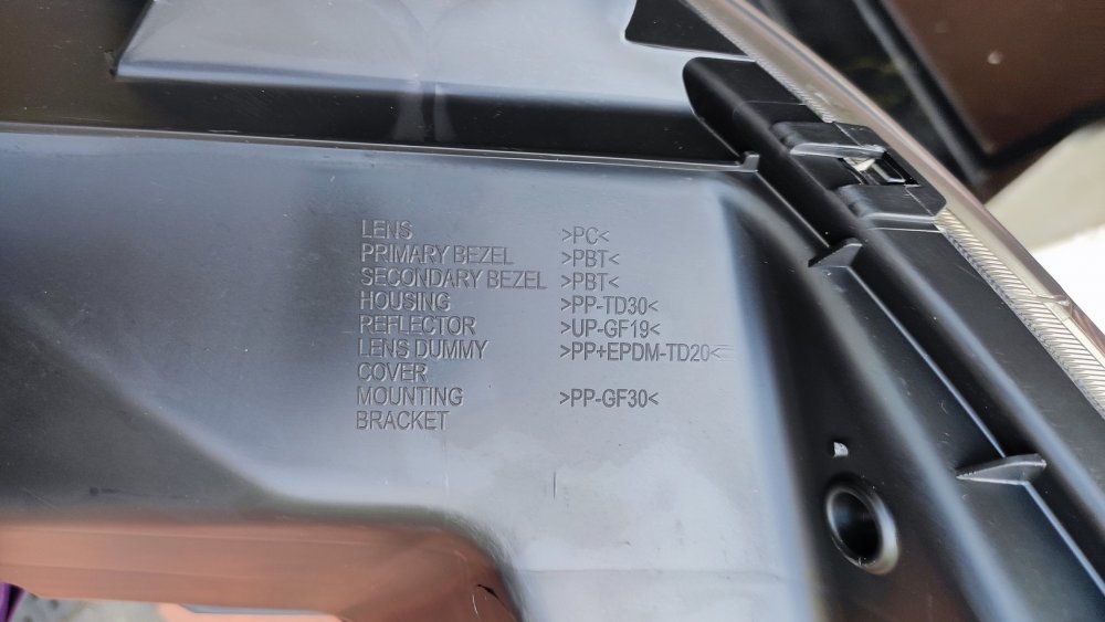

Made in Korea

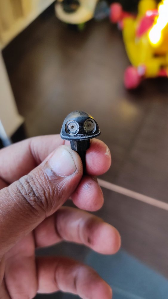

Windscreen washer nozzle was painted shut. Poked it open and cleaned with thinner.

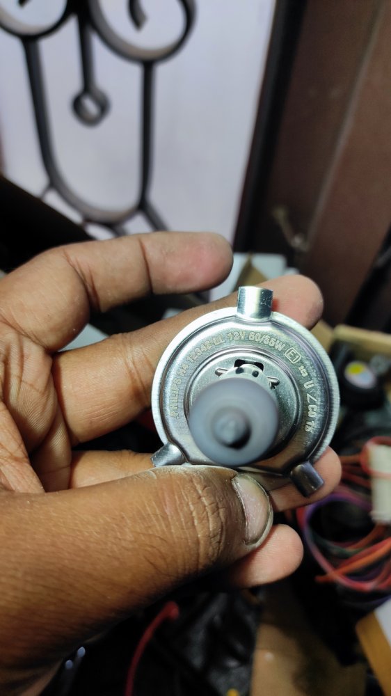

Headlight bulb was Phillips make.
