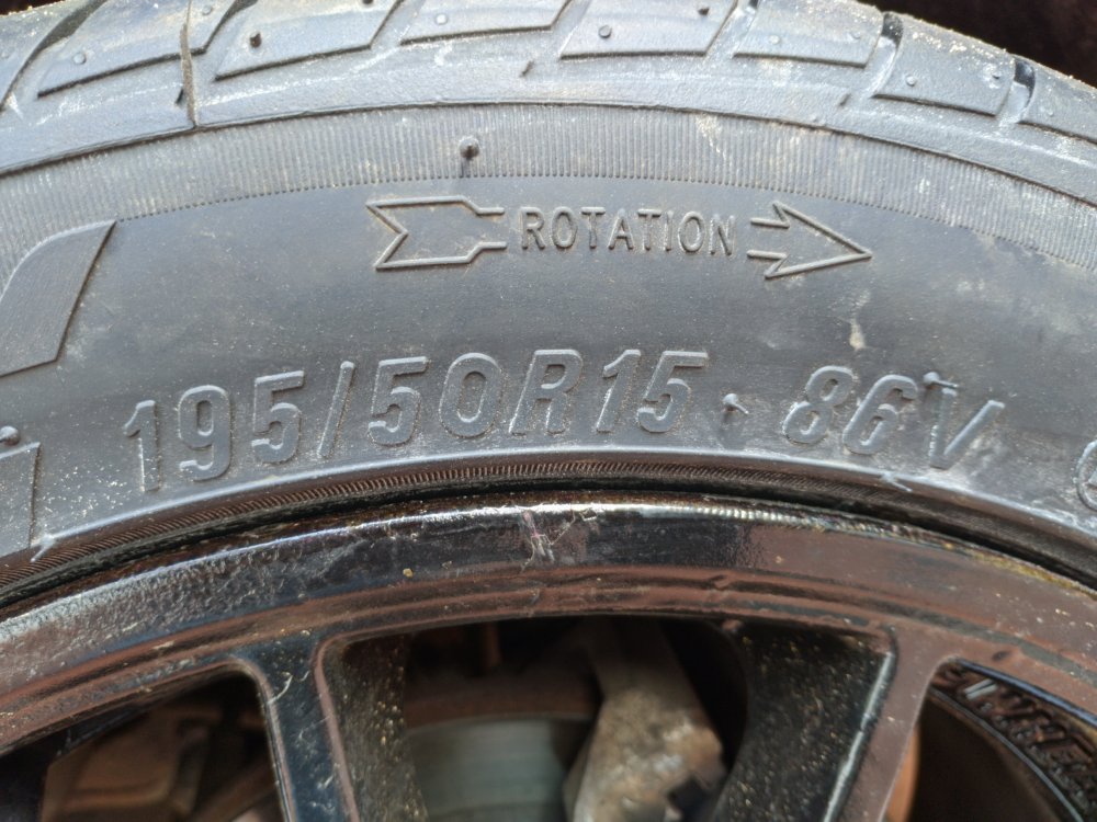

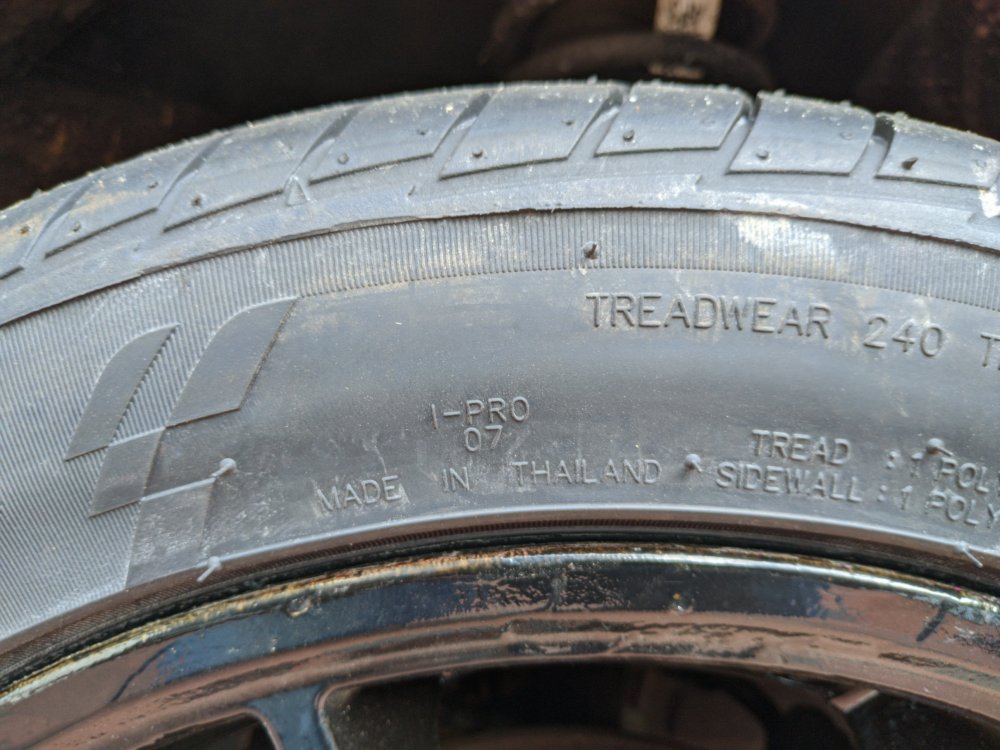

June 2020 - Finally New Rubber - Maxxis Vectra iPro 195/50R15
Wifey was feeling very uncomfortable with the low profiles as slightest unevenness on road was felt inside, so was planning to change next month, but then the thunder struck, the news of import ban. Asked brother to check with the dealer on the way. I was planning to get some Accelera Alpha, PHI-R or 651 Sport or Achilles ATR Sport or at least some Nankang model. He went to Nayana Tyres and the tyre guy rang up other dealers and distributors to check availability and import tyres already out of stock at most places and he came with the pleasant surprise, Maxxis Vectra iPro, one of the options we were looking for Fiesta then. And more sweet part was the pricing, it's cheaper than all the options I had in mind. Asked him to get a set. He ordered them right away, even without taking any advance amount and promised in 1 day, but delayed by 2 more days due to COVID situation, but he promptly informed the delay. The changing staff was experienced as well. Did a quick job without damaging the freshly "jugaad" painted wheels. Changed rest of the 3 wheel stems as well. One was changed during first lock down.
Maxxis Vectra iPro 195/50R15 - ₹ 4,350.00 x 4
Tyre Valve - ₹ 100.00 x 3
Wheel Alignment - ₹ 400.00
Wheel Balancing - ₹ 500.00
Total Damage - ₹ 18,600.00
Maxxis Vectra iPro 195/50R15. Made in Thailand.

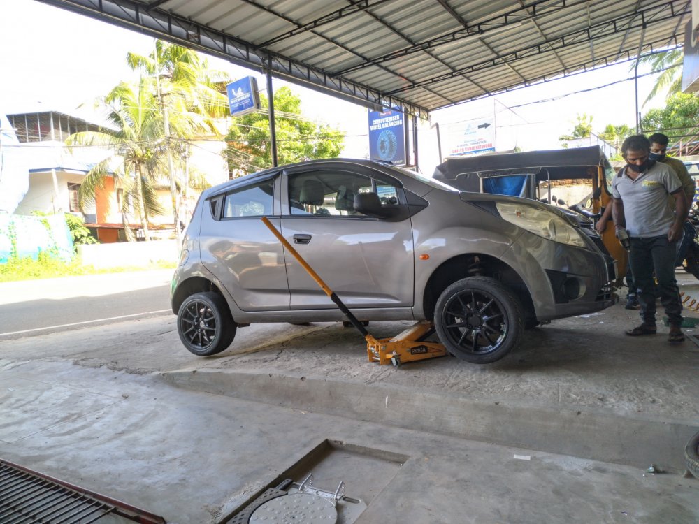

Jacked up like Chris Fix.

Cool tread pattern. Way too silent than the previous Sonat and Nankang tyres and obviously comfortable than the low profiles.
Maxxis
Victra i-Pro
195/50R15
March 2020 make.
Made in Thailand.

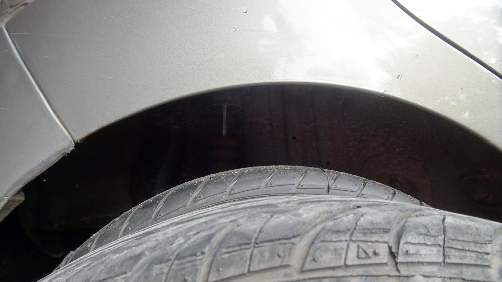

195/45R15 vs 195/50R15
Old tyres. Two of them ran approx 3-4k km only (if the previous guy was right). I used them barely 700 km. Sold them on Olx. Got 3.5k for two of them. Gave the other 2 for free.
Enhanced looks.

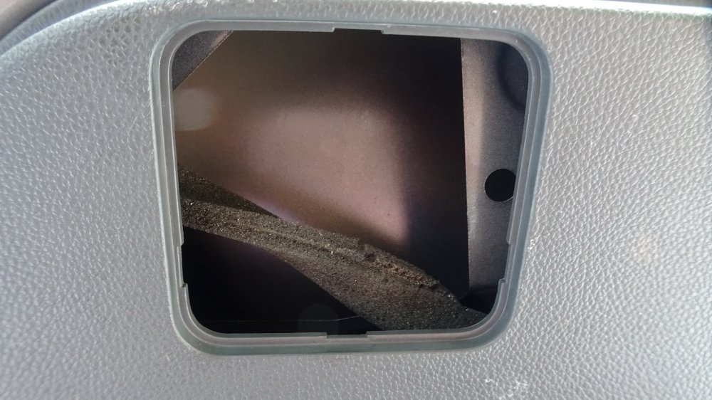

June 2020: Corona Time pass - Checking scope for rear wash and wipe.
Just one screw.
Another access,
but nothing in there.

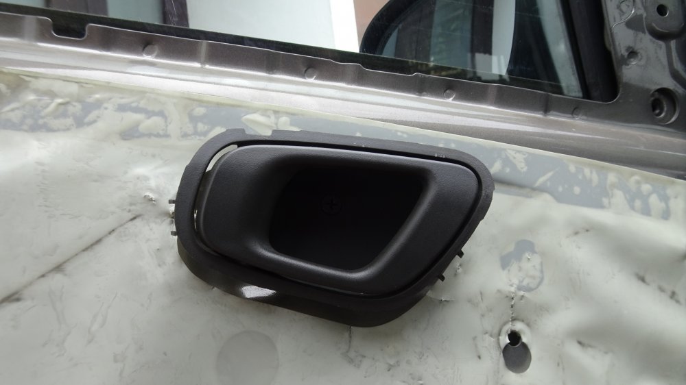

June 2020 - Squeaky door pad
For some time, the LH door pad was making squeaky noise intermittently. At first, thought it was the panel covering the seatbelt. Was too lazy to check it. Incidentally spotted gaping in the door pad and noted the dislodged clip. I don't remember removing the pad or the need to remove it the recent 2-3 years.
To start with, have to remove the ORVM adjuster cover.
It'll come off with just a pull.
Just 2 clips holding it.
Without the cover.
Two screws, one here
and one holding this.
And a gentle pull, the pad comes off. Disconnect the power window switch.
No tarry glue like Maruti.
Removed the clip with gentle prick with screwdriver. Harder to remove than the Maruti ones.
Found second dislodged one.
Installed and clips and installed the pad back. Happy ending.

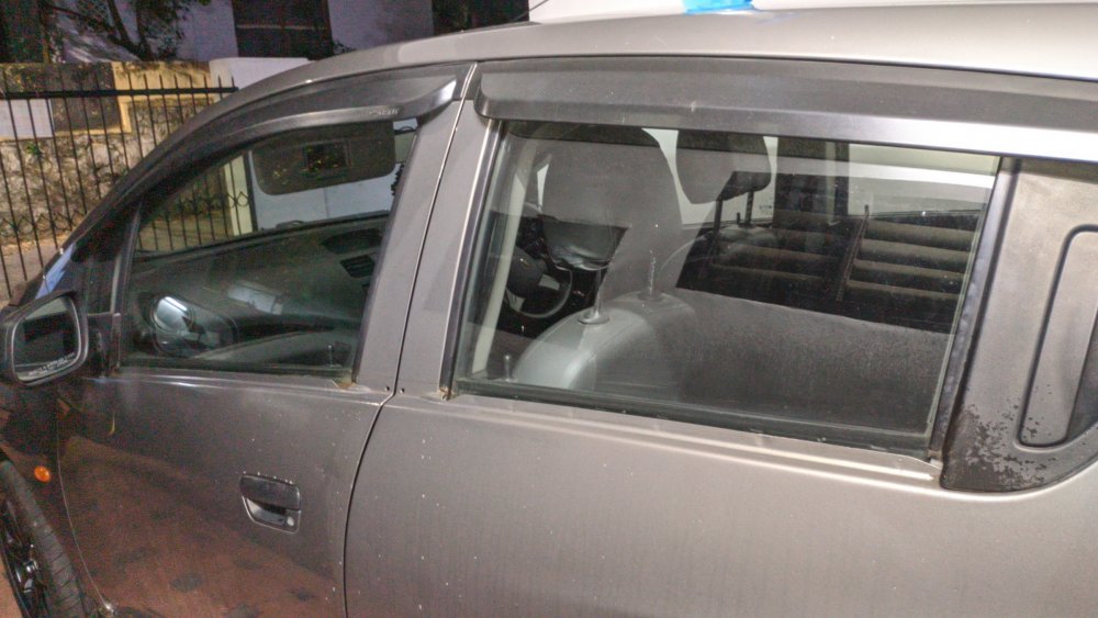

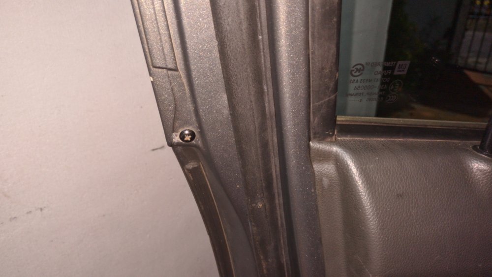

July 2020 - Black Pillars
I was always fetish about black pillars since I could remember of. First ever mod I ever did on any car was black pillar (and a gunmetal rims painted with a vacuum cleaner) in my teenage some 15-18 years ago. It was on my friend's Zen (which happened to be the first car I drove and the first car I crashed). Ever since then, I wanted to do the same with our household cars, but unfortunately all of them either came with factory black pillars or were black cars. I still remember pursuing @ilango[speed thirst] to do it on his Estilo in Orkut times and still behind @vishnu vichu do it on his Amaze.
Finally, did it on my boy.
Materials needed. Grabbed sister's hair dryer. Most helpful around the edges. Matt black vinyl, got it from Bhavani Stickers. Run by some Hindi-speaking guys. They got great collection of vinyls and related stuffs and tools in Trivandrum. With COVID, their regular staffs who understood Malayalam left for their home town and had a tricky time getting the sticker. He was repeating ₹120/sq.ft, and I was like WTF. I asked him for 1 x 4 ft, and he was saying price for the 1 x 4 only, ₹120 total. Squeegee blade, I had for some 10 years. That guy got a great collection of newer models and too tempted to get them. Normal paper cutting knife. Had at least 5 stainless steel ones, I hate the plastic ones. I misplace them during DIYs and not even a single one was found and ended up buying plastic one. Again, that guy had some amazing premium steel ones.
Colin, the inevitable.
Start off with cleaning the pillars.
Remove the window trims. Held with single screw behind.
The dirt ever since leaving the factory.
Clean it.
Pull apart the rubber beading. Start off the work. Put'em back when done. With blower/heater, working through corners and depression is pretty easy. Back those days, would end up with swollen and cut fingers.
One side done. Did the missing A-pillar as well.
Repeat on the other side.
Final outcome. Black pillars come default in top variant of Beat.

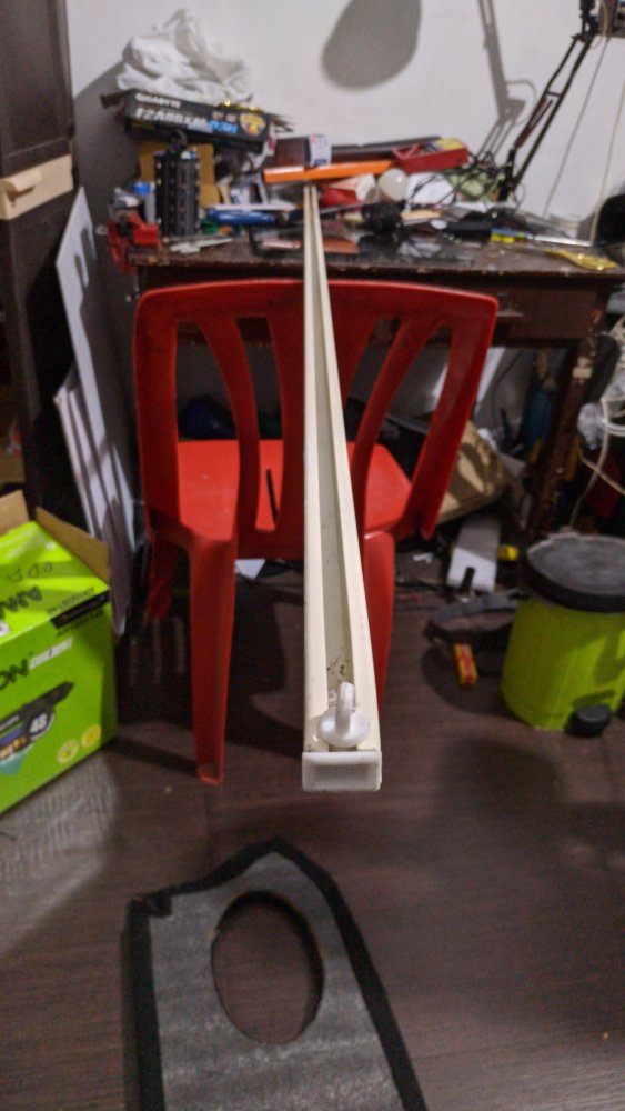

Then the thermoform and cut to shape. Pour superglue drop by drop at places where there is chipping. Learned from Chinese DIY videos. They used superglue and noodles to fix chipping.
Old school. Reinforce with rectangle section curtain rod. Scavenged from home [evil] where curtain was missing.
Cut and painted black. Stand on the board while screwing to get it straight. Had the right number of star wooden screws.
Installed mounts back. Could've painted them black.
Ready to install.

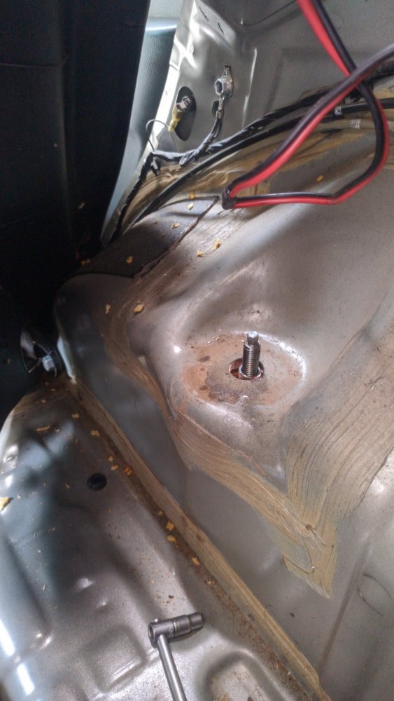

Before starting off, support suspension bottom with a jack.
Top part of the suspension without the cover. Aftermaths of old rat attack.
Need a 15 mm open-ended spanner and a 6 mm socket.
Hold the socket and loosen with the spanner, or vice versa.

Jack up the car, needs a second jack.
Remove the bottom bolt, 14 mm. Better to loosen it up before jacking up.
Slowly lower the supporting jack and the shock starts coming off.

Tada. Done. Don't forget the top cap. Vacuumed the rat debris.
Deep cleaned the boot and installed everything back.
