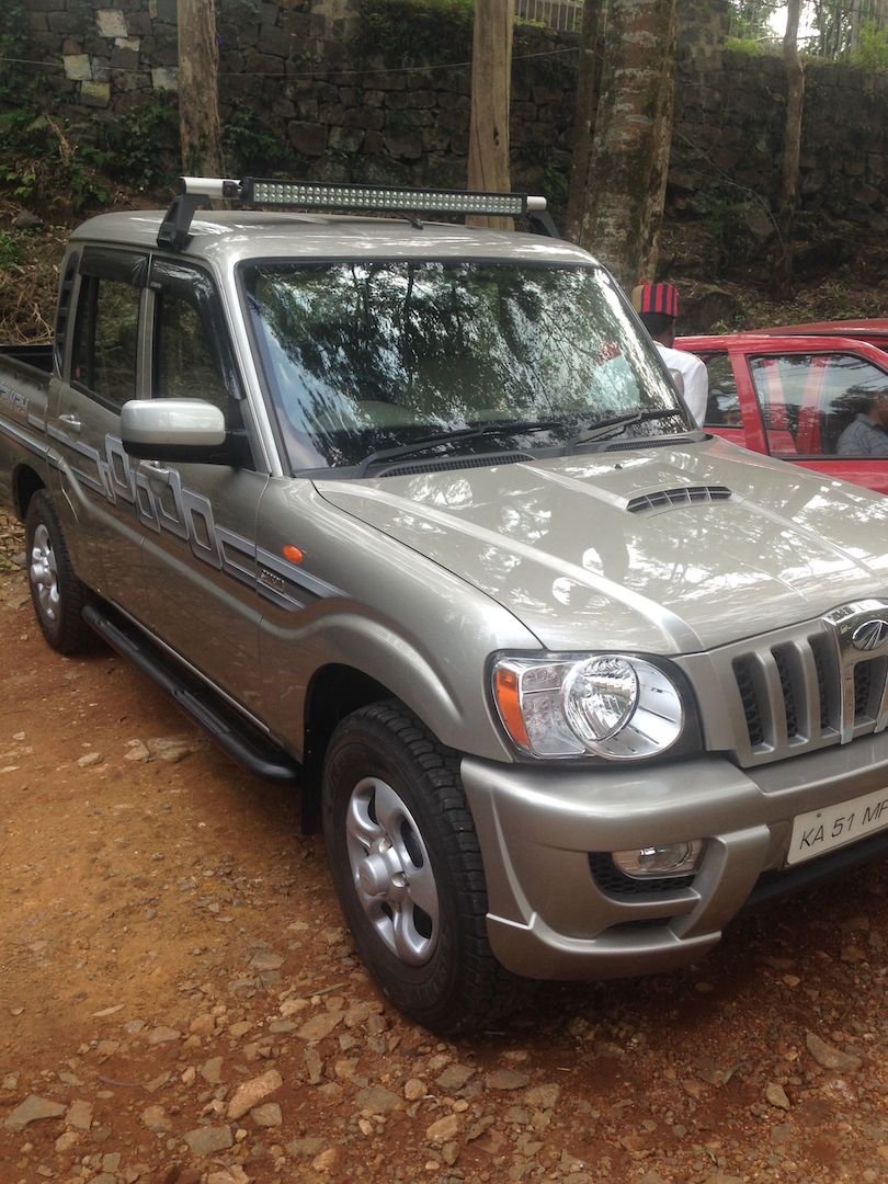

Hi Incarnation, Its a 4*4 3 Litre Dicor.... the 2.2 litre was supposedly 2 lakhs costlier ( that was supposedly smoother engine). This costed me around 9.5 on road bangalore.
Plus another 1.5 for my urges. ;-)
Yes it came with stock 16 inch wheels and tyres (215.75.16). I changed to 15 inch steel wheels (infiniti brand) and tyres to 265.70.15 (yokohama geolander AT) .
The reason i went for 15 wheels and such a tyre was because i wanted more tyre and less steel for a smoother ride as i was raising the vehicle.
I did raise the suspension to ARB Old manemu shocks which raised it by 3-4 inches. one reason was a smoother ride and the other was because wider tyres tend to rub against the body while turning ( a problem i faced with my previous xenon) now i don't have problem .
the side step is a genuine Tata accessory and it costed me around 11.5K
I had to cut the mud flaps and a bit of fibre body to enable undisturbed turning, the net effect is that my car gets a lot dirty during monsoons.
