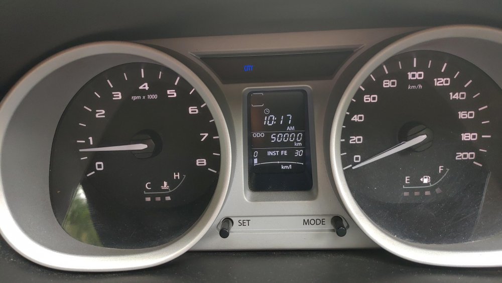

[drive]50000 KM Milestone [drive]
Tiago has crossed 50K milestone on 21-Oct which is 1236 days since D day. This is roughly 40 Km per day / 1250 Km per month, which is way more than what I calculated before buying a petrol car.
Since 50K is a special number, I have a gift for this little guy which was running at the back of my head for quite a few months:
