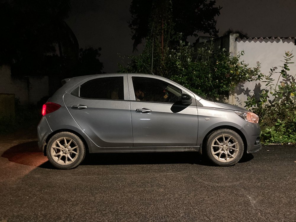

Got a major performance update, as a birthday gift for her.
Part - Lowering Spring
Brand - Cobra Suspensions, Netherlands
Spec - Front Drop 25 mm, Rear Drop 20 mm, progressive springs.
Getting ready for her spec boost.
Before
Front Wheel Off
Front Strut upper mount
Strut off the car
Work in progress
Cobra Springs(left) vs Stock Springs(right)
More Work in progress
New Springs Installed on the strut.
Front Strut with new springs mounted.
Rear Wheel off
Rear Strut off
After
Before vs After comparison.
Initial Impressions
The stance hasn't noticeable changed much, but it looks good enough for me. The body roll has reduced, bounciness on bad roads at lower speeds has reduced. Steering feel is better and the car feels more confident to drive. High speed performance yet to be tested. Wheel scraping when 3 people on board remains the same like before. Need to test with 4 people and luggage and see if it also remains the same.
Need to get the wheel alignment done and then go for a highway run to properly test the new setup.

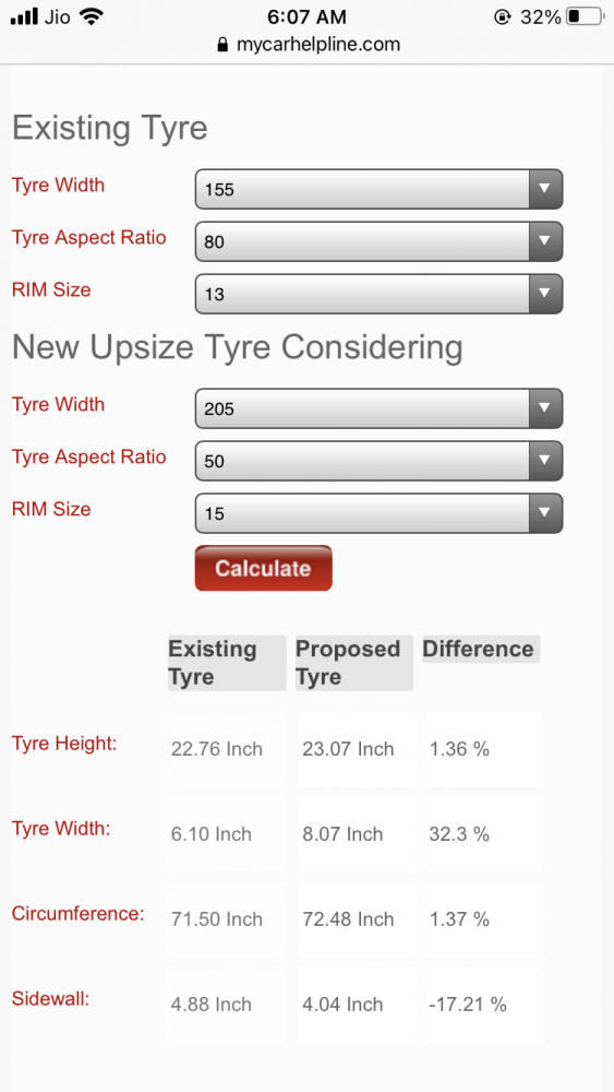

205/50 is 1.4% difference only. It is a stable upsize only. I have done proper studies and only changed. I didnt get 195 section at the time of my upgrade. Thats why had to go to 205’s.

Maybe the website which I was looking on was inaccurate.
I have upsized in my cousin's swift zdi(2012 model), from stock 185/15" to 205/16". There as the wheel well had adequate space and also the suspension was tweaked, by rising(Am sure that it wasn't lowered). No trouble was encountered, the ride was more planted, stiffness was same as earlier stock spec, as the suspension was adjusted not to cause more stiffness.
It happens to me too. Thats why I always seek advice from trusted and experienced people in my circle(perks of being an Automobile Engineer) before going for any mods.

Simplest thing I follow is reduce aspect by five for every inch increase of rim and for every 10 mm width increase. You would get a rough upsize. Keep them side by side and see whether it's way different [cheers]. Fit them and live in peace [evil]
After all these sites started confusing, I took a scale and went on a measuring spree and none of the heights were close enough to what's mentioned, especially the aspect height [lol]
