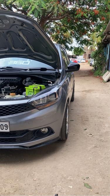

June 2022
Odo 20050 Kms
Got the fourth service done at my friend’s garage.
Clogged Air filter
After cleaning and Oiling
Total 8000 5w30 Fully Synthetic Oil and Tata Oil Filter.

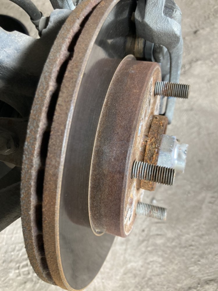

Cleaned the brake pads, callipers, rotors and greased the calliper pins. Brake Pads will last 5-10k kms more.
Inspected the Cobra Lowering springs, checked for battery distilled water level and cleaned the cabin air filter.
Got the wheels balanced, rotated and aligned.
Odo at 20059 kms
