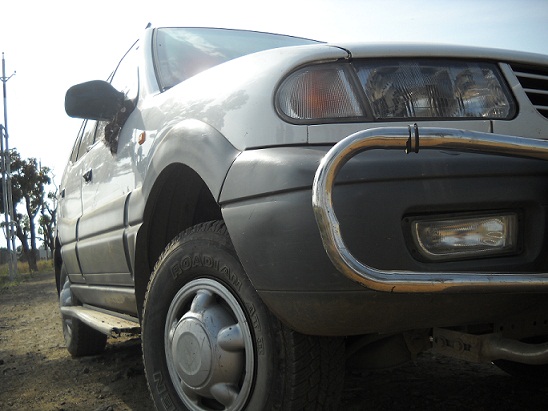

Some of the pictures close to my heart:
Note: I am a no Photo enthusiast, so please bear with picture quality.

Welcome to TAI. I hope you will enjoy your stay here.
Nice review with your Safari. I guess you had some issues in posting the pictures. Please check out and post the pictures again.
Yes, I had problems posting pictures that's why the images appear tobe resized. Thanks for the link.[thumbsdown]
