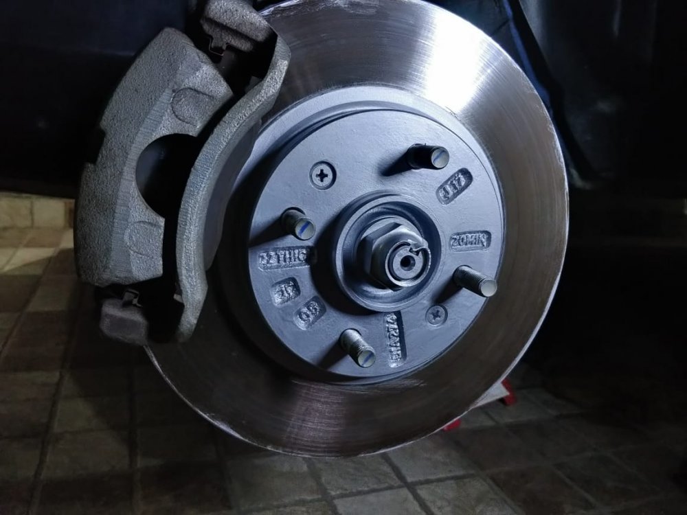

No,not at all. I can't blame tata because it's my fault. I was repeatedly using boring water for washing and pointing the water jet at the rotors to clean up the black dust off . This type of rust can be seen in other brands too.

Pls wait, I will write why I am against to sanding and painting. If you want it must be resurfaced on the l lathe machine and can be painted but not this paint. Having severe migraine could not concentrate on anything.

Well I removed the rust from the rotors today. It took a lot of time and effort, as there is no space to work in the wheel well. Moreover fingers get hurt if one is not careful with the sanding process. Anyway it gave me lot of satisfaction while working on the rotor. And satisfaction is very precious to me, mind you.
One might be not satisfied with a Mercedes, and on the other hand one might be totally satisfied with an Alto! And I believe in that case Alto owner has actually attained nirvana! So satisfaction is a relative term you see. So coming back to the topic, removing the rust myself gave me immense satisfaction, and now I will be looking forward towards painting the rotor next.
Before sanding
After sanding
Hoping it will help somebody at least !

@mayankdixit, I hope you left the car on jack stands, you can use heat resistance transparent spray because keeping the car on stands for extended hours not good. We discuss leftover things later. Thanks for your medical advice my migraine is fading away.
