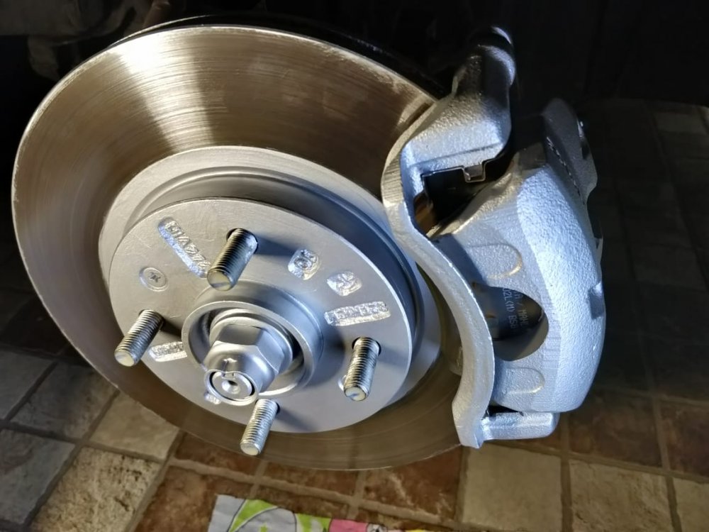

I have left the front wheel of left side as it is for the time being. Thank god there was no puncture on the road otherwise I would have been in a difficult spot with the wheel jammed and all.
In the meantime I have sanded and removed all the rust ,dirt and grime and painted the right front rotor in the original colour. Hope this DIY will last for a long time.
BEFORE
AFTER
Thread Starter #869
May 16, 2014
1,483
2,712
kanpur
Contrary to many people opinion I am not for sanding and removing rust in that area many reasons for my opinion. Anyway good job by mayankdixit.
Please do elaborate on your statement. I am aware that you have knowledge in that area so I am interested to know your reasons. Moreover other forum members will be benefitted too.
So tell us why you are against sanding and painting?

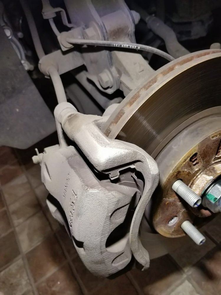

Ultimately succeeded in removing the left front wheel with the advice from @Suryaputhra !! Thank you friend.
Well now I can see why the wheel was not coming off.
Rust,Rust and more Rust!
I think this side has more rust than right side.
Wheel rim was stuck here,and the wheel stuck marks can be clearly seen on the rotor.Luckily the rotor was not damaged with all the hammering and pulling which it was subjected to.Now I am in 2 minds.Whether to follow @Suryaputhra advice or paint is like the other side.
