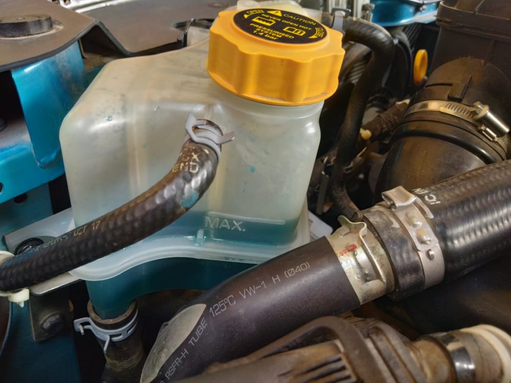

It has been 3 years already with the Nexon ,and I was noticing deposits in the coolant degassing bottle. I wanted to do it myself at home,so I purchased 4 litres of coolant and went about changing it with the help of my son.

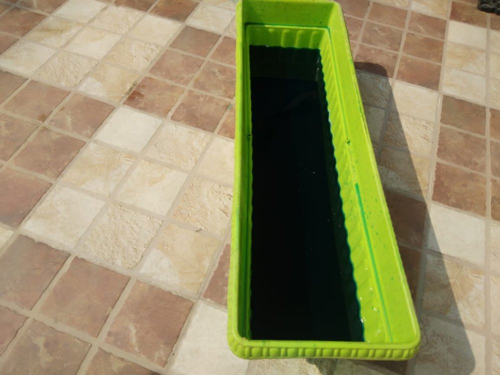

I collected all the coolant in a container to measure how much came out
Debris in the old coolant

Old coolant was dirty, dark and debris filled

I idled the car for 15 minutes.Coolant level went down.I filled up again.I repeated the procedure 4 times. I opened the AC vents to full heat during all this.
