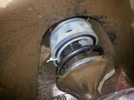

Lately, I was not very happy with the suspension of the car due to increased depth & number of the potholes on the roads. Also while crossing the unscientific sized speed breakers I had to slow down to snail's pace whenever the car was loaded.
Looking at the recent trend of mini SUV s with high GC, I wished I get some improvement in the GC of my car as most of my running is on the state highway and roads described above.
I installed 'Urathane cushions' on the springs of my Manza
Results :
1)GC improved by almost 25mm, effect is felt especially on the bumps, I need not slow down too much while crossing 'em.
2)Body roll nullified especially in Ghat sections at good speeds.
Cost :Rs 10, 000.
Time required for installation :1hr approx.

@Shail1061, cost is the Rs10k total for all four springs.
Cheaper materials to improve GC are also available in the market, but its usefulness for reduction in body roll and improvement of suspension is unknown.
http://www.theautomotiveindia.com/forums/technical-zone/15195-coil-spring-adjuster-2.html#post403746
Seems to be an useful thing to add. What about longevity?
The installer told me that the material is utilized as a foundation for ship engines and lasts 50 odd years, he also asked me to remove them at the time of selling the car as they can be reinstalled on a new car if the new car springs are of compatible size.
