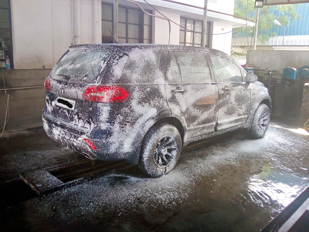

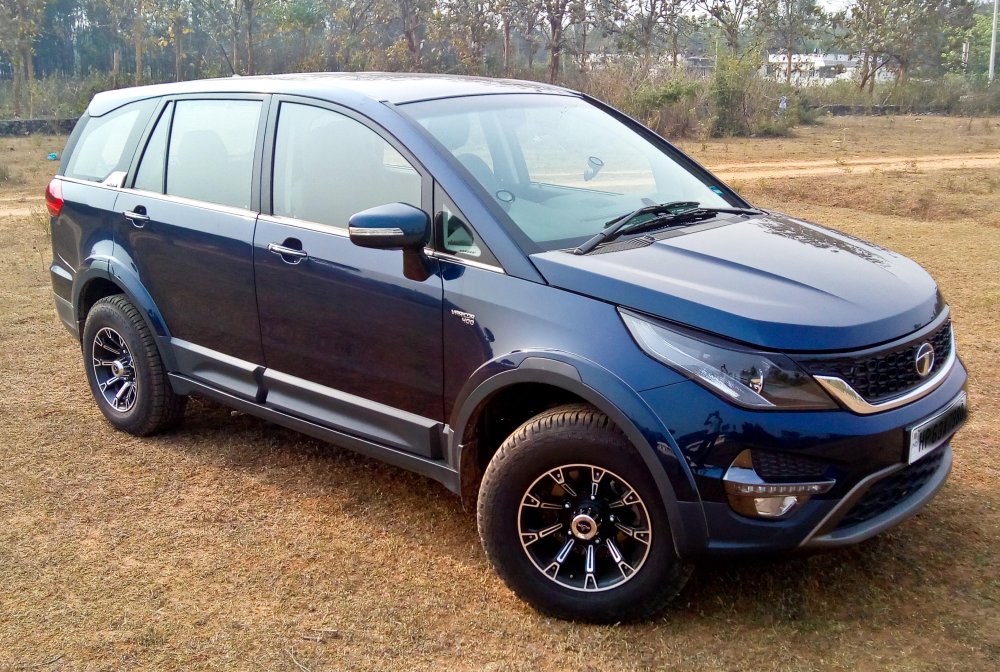

Anyways, an update. I changed the stock tyres/ wheels of my Hexa XT 4X4 to 16" Plati alloys and 235/70/16 Michelin LTX force tyres.
Here a few pics of the tyres and the Hexa in its new get up

The new shoes very well compliment the Stance & Looks of the car. What did they cost you?
BTW this is Safari Tyre size.

Thanks. The tyres were 8.5 k apiece and alloys 7.5 k.
Wow, That is a really good tyre profile, platis look chiseled , now that Hexa is on 16", how comfortable is it when compared to 17" ?
The original wheel size for Hexa XT/ XTA variants is 19", not 17". And yes, the ride is way more comfortable with the 16"

Tyres are looking good.I like them.
Alloys are looking good and beautiful too.I love them too.
Michelin is the best out there. But why are the tyre jutting out of the fenders compared to OEM tyres ?
Is it because AT tyres are wider.Even though the spec is same, ie 235. This should not happen isn't it?
Or is it just the pic angle?
What did you do with the OEM 19 inchers?

AT seem to have squarer shoulders making them jut out just a little bit. Another thing could be offset on alloys.

So going by the above chart, the ground clearance of car has now actually decreased by 2-3 mm (by going from 19' to 16 'tyre)
Please correct me if my deduction is wrong.

The tyres are not wider, they are same 235 mm as the stock ones. Its just the offset of the alloys thats making the tyres jut out a little. And yes, the ground clearance has come down from 209 mm to 200 mm with these tyres, since the overall diameter of the tyres has reduced a bit. Although this change in dia is within acceptable limits.
Regarding the stock tyres, I sold them to other Hexa owners, who were looking to get 19" alloy + tyre for their spare tyre, which otherwise is a 16" steel wheel / tyre.
