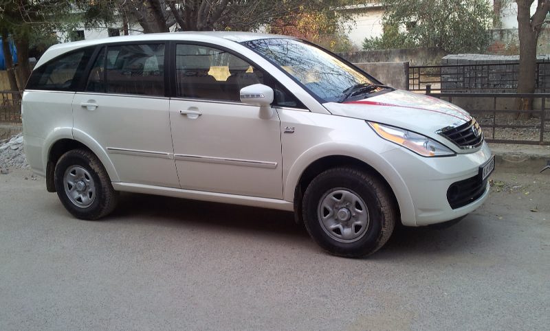

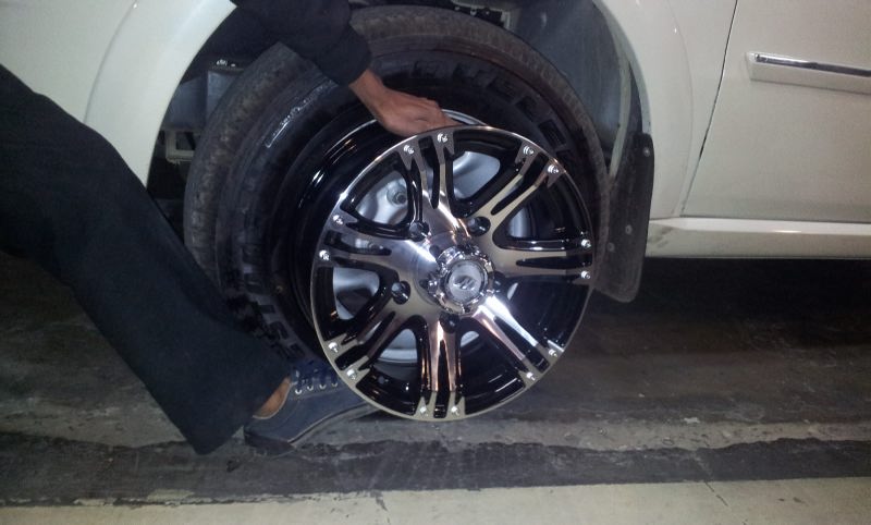

First of all a very good morning to all the TAI Menbers,
Here are the coveted pictures of my Saphira........
They are shot from SII as my camera is with my friend and a detail photoshoot is still pending....
This is the design of alloys finalsied for My Saphira (next month or may be in April)...
Vkool (60% heat and uv rejection) film is installed on glasses, but very less tint..... (they are effective so far, will share their effectiveness next month onwards)...
