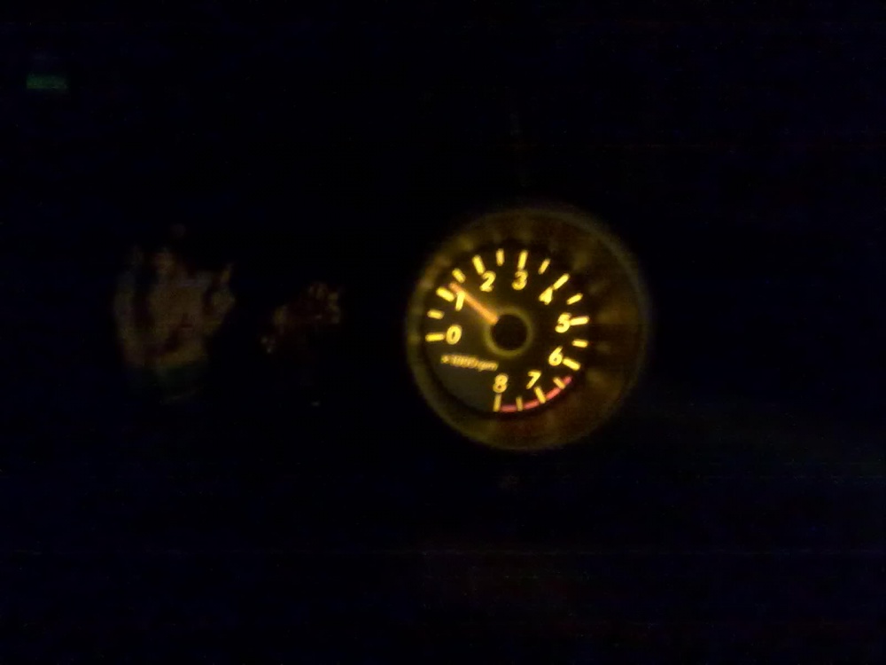

Hi
I have installed Ritz petrol Tachometer into my alto. Its worked like a charm sharing some photos
I found an issue on Today's office drive on NH 47 straight stretch I pushed the gas pedal on third gear to maximum but engine not going beyond 5500 RPM. What could be the issue and any remedies?. And what is the idling RPM of 800CC Alto?

Hi
Kudos [evil]
Tried revving in neutral??? Idling should be around 1k rpm (mine is 900)

Its looking great, it would be better if you change the back lit to red..
In mine (A-star tacho) when I floored the pedal it went up to 8 k rpm, then my car use to make weird noise.. I guess the A-star is best for your alto.

Kochi
Yes Varun I ordered A stars one., please let me know if anyone need ritz one for their 4 cylinder Maruti
