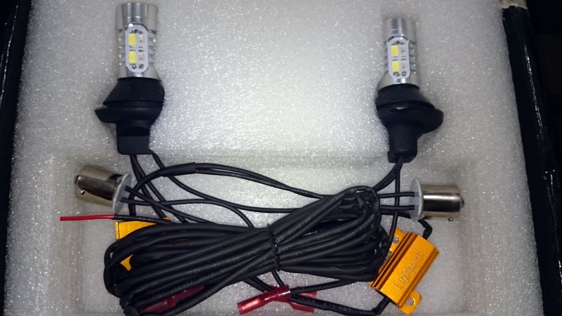

The Box
The Contents

The DRL function is quite good and the white light is pretty bright. The light is accentuated by the fact that the optics meant for the original bulb are also being put to use. The way it automatically switches from White to flashing Amber once the turn-indicator is used or vice-versa is pretty seamless. It automatically switches off the DRL function altogether once the turn-indicator is flashing so that there is no White - Amber switching when using the turn-indicator. The load resistors provided in the circuit of the turn-indicator prevent hyper flash associated with LED bulbs when used for turn indicator and the flash is synchronised with the rest of the bulbs.

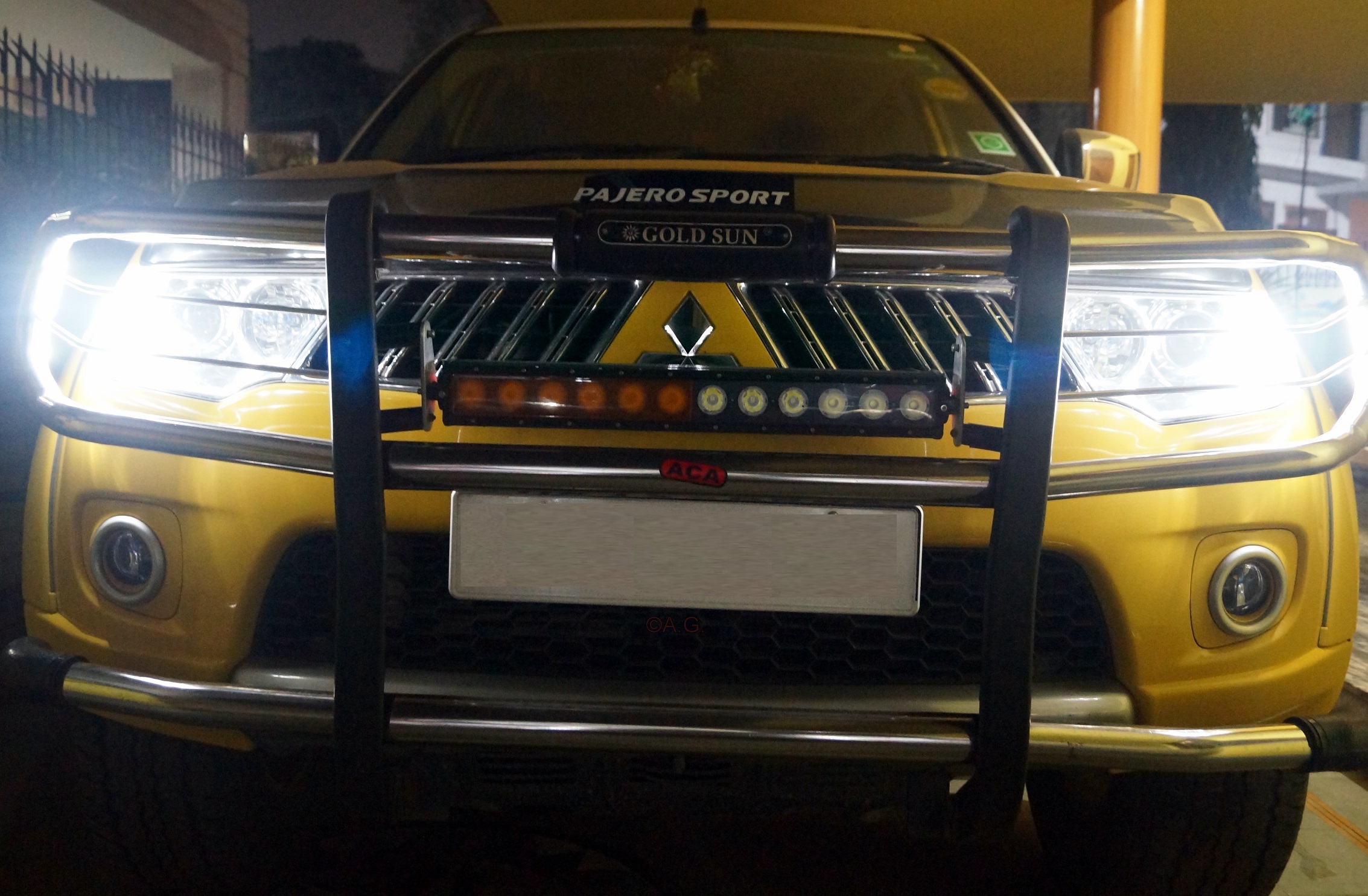

Close-up of front with one side as DRL and other as turn-signal

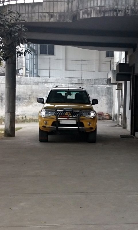

View from 90 Feet with DRL ON

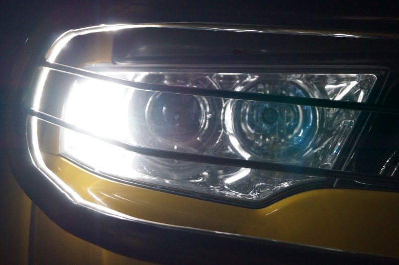

Night view close-up of head light in DRL mode
Night view close-up of head light in turn signal mode
