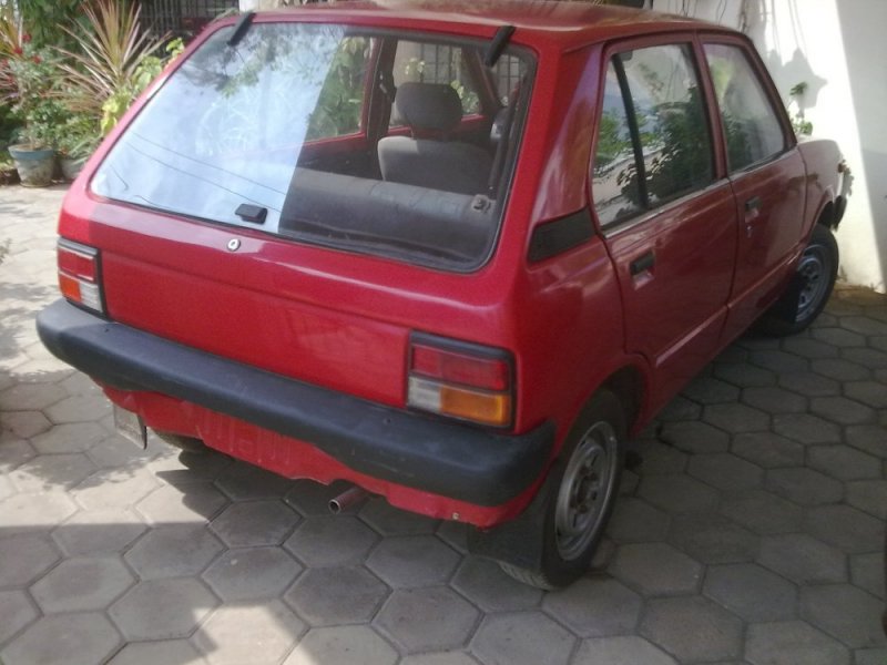

Few pics of my SS80DX(after paint job was done few yrs back), Ikon and my BIL's Santro is below.

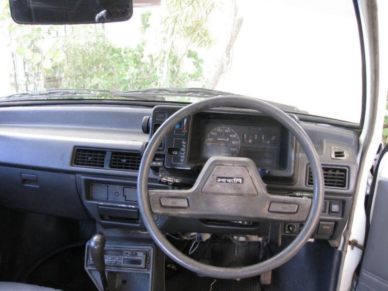

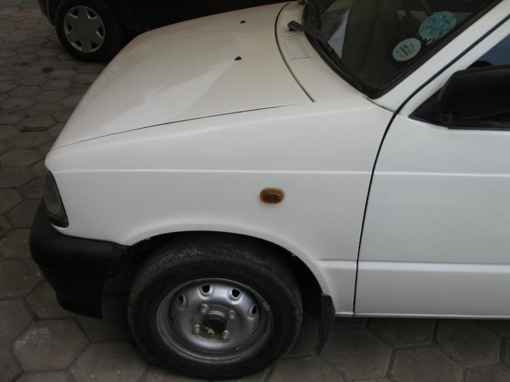

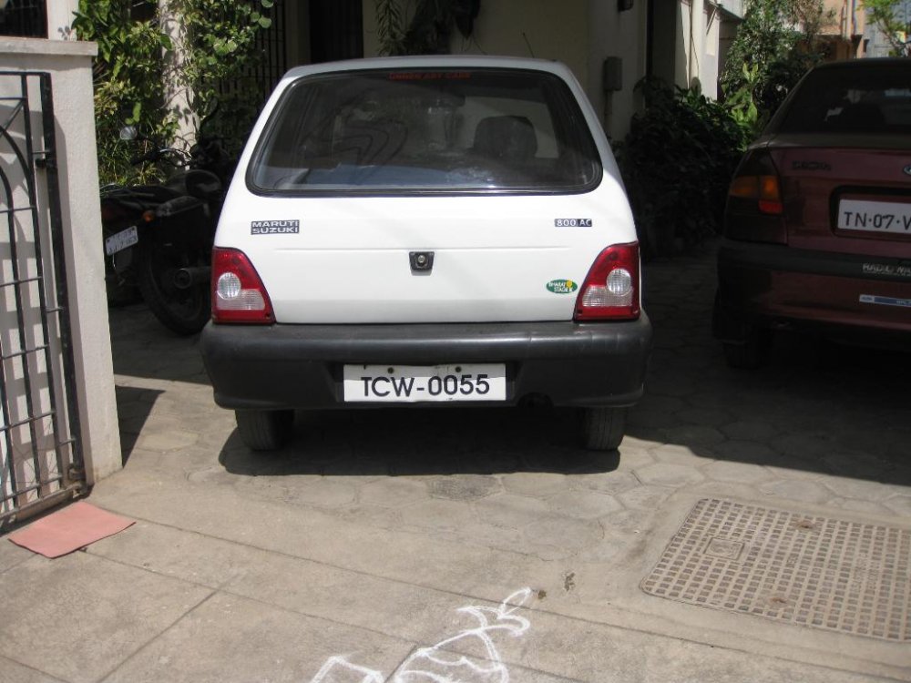

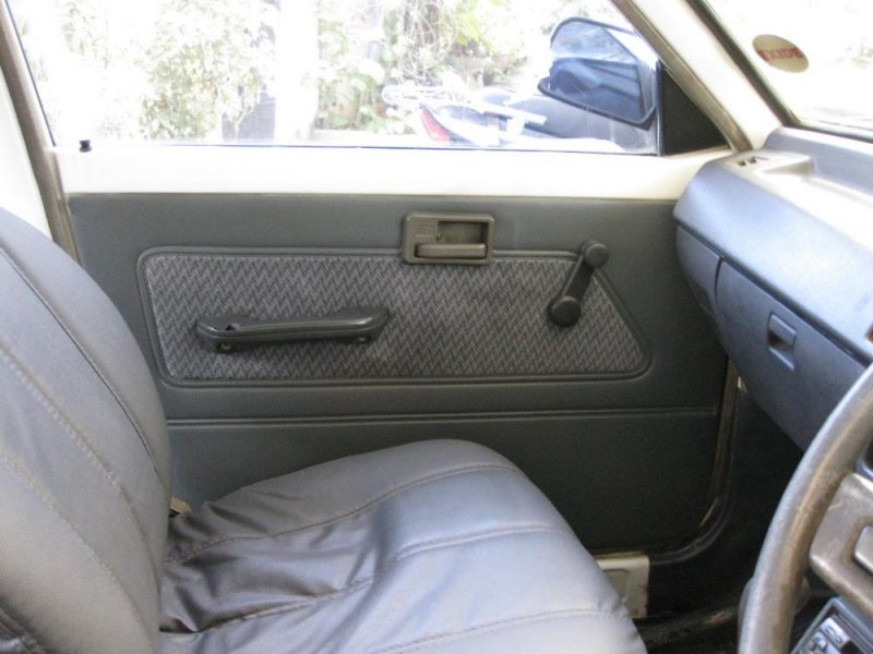

Re: Suzuki Twins SS80DX(1984) and Maruthi 800 DX(1987)
Guys here are some pics of 1987 M'800
Hi Bharat,
You have changed the look sof your 1987 model to that of models in 2000 rite?
Yes satan i guess it looks like some what of Type 3 (2005 & above) except of the Headlight and the dashboard. I did not wanted to add latest headlamps because it is made up of plastics so i stuck with the glass one of 2000's.
I am currently in search of dash. I got one of but i did not get the console's. My next part of the upgradtion is addition of new tyres and A/c.
