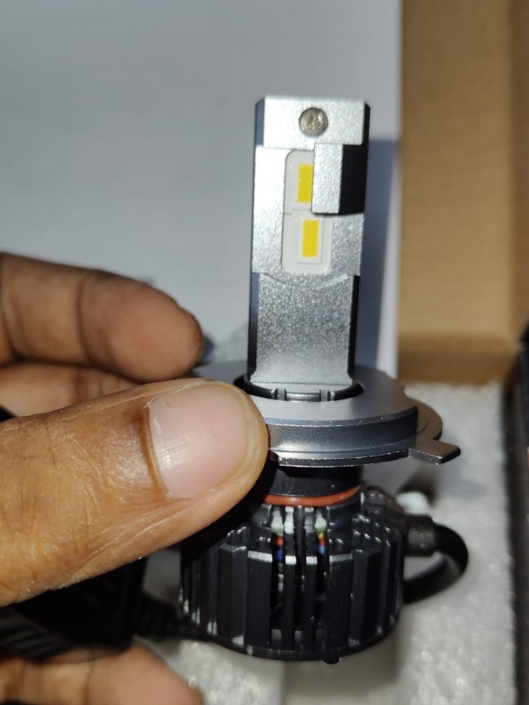

There is a copper heat sink running through the center for cooling the LEDs

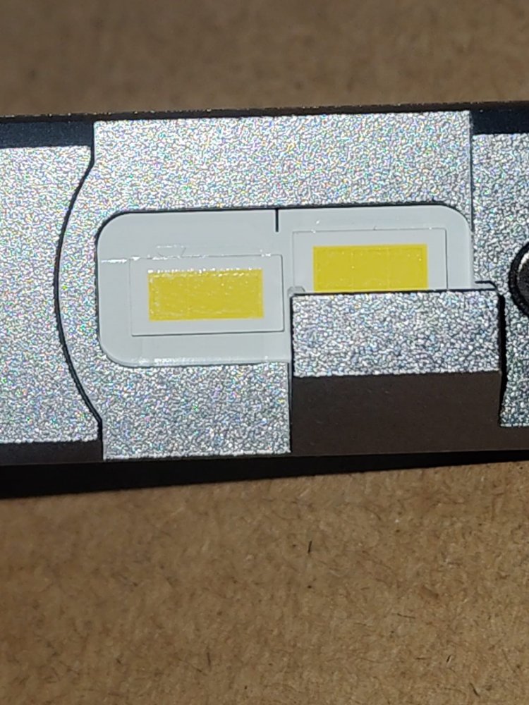

There are 4 LED chips in each unit, with 2 on each side. Notice how there is a shade given for both LED chips at the front. This is what enables a perfect cut-off at low beam to avoid blinding oncoming traffic. This shade has to be precisely at a particular measurement to get an ideal beam. This is what most Chinese LEDs lack.
