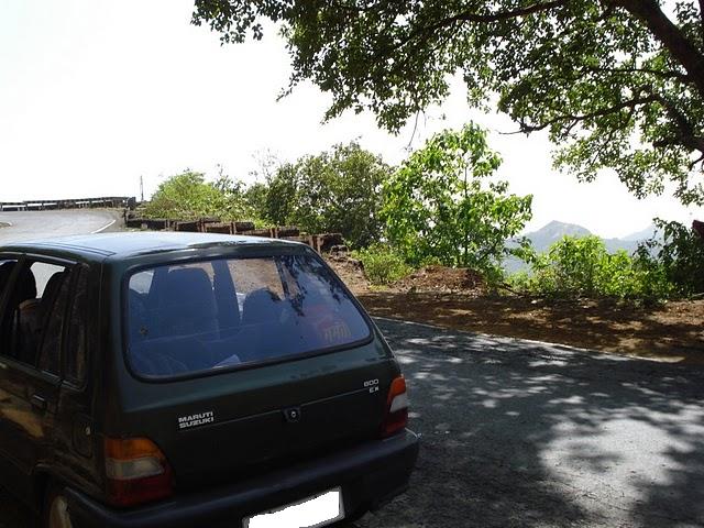

Few Glimpses of her..
Bottle green color very well suited her, and made her distinct among similar creatures.
Sometime people asked me, Do I work with Defense? Looking at the her (Later I realized that It is because of her colour)
Whether it is steep ghat sections or slope she never refused to run!
