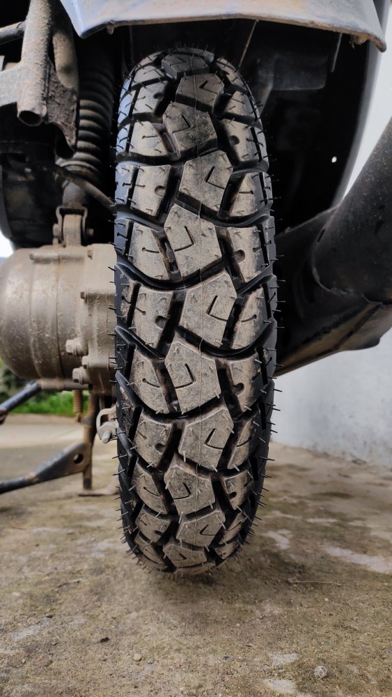

Got a more button type tyre for the rear per his recommendation.
Apollo ActiGrip S5 90/100-10 - ₹ 1,300.00 (MRP ₹ 1,575.00)
December 2023 end make. Even fresher piece.
