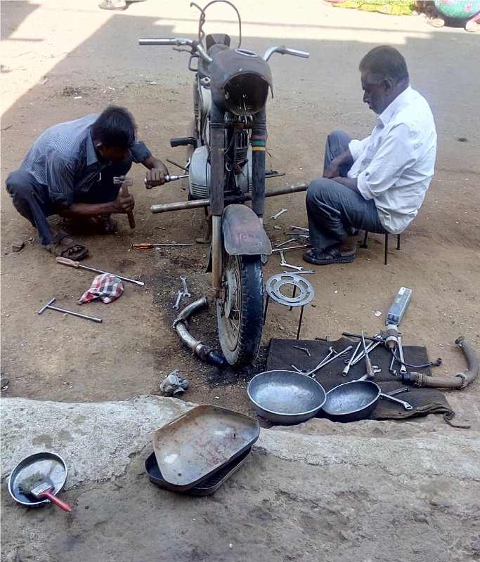

About mechanic: Forgive me if it looks like out of topic, but I have to share this for people who are enthusiast about machines, and for the people who really in need of information for example people like me who collected lot of information before restoration. Believe me I read Ananth's post more than twice.
Mechanic name Shafeek, He started working on machines since 1975, He talks less, works calm he is cool. I am inking it one by one.
1. He dis assembled the bike with too patience as it was totally jammed kick liver was struck, engine plate was not coming outside, when it was unable to remove without hammer work, when he was operating with hammer I thought anything may break but I was wrong it came easily.
2. His advice on changing parts is really appreciable. As petrol tank was totally rusted from inside he told to replace advising for future problems. Replacing shock observers, advice in tyre selection. When automobile shop keeper told block piston i mean piston with block price 7000 Rs, He told its maximum cost is 2500 don’t worry we will take only piston I will change cylinder sleeves for standard piston size. Ignition kit(rotor and coil assembly) he replaced from his stock considering higher rates in the market for Jawa spares.
3. For spares purchasing he came to Mysore on my request and he himself giving priority for genuine parts that he can recognize which I can’t. Reached Mysore at 12pm and return train was at 4pm within this period he managed to get almost all spares purchasing that is also without having any food. He mentioned work is more importance for me.
4. I told the Junior mechanic(mechanic’s son) to video shoot the first kick start either it may start or may not start whatever it may be I want video without fail. Finally I got video where Junior mechanic started it for the first attempt and his surprise expression is recorded in the video. It will be lesson for the juniors what the perfect engineering is. In other angle how much simple mechanics is there in Jawa machines, A machine which is kept idle from 20 years in the bad atmosphere without care [anger].
5. He told his experience with Driving Yezdi, he used to take 40 minutes on legendary bike Yezdi from Bijapur to Bagalkot(84 kms). Really he is a crazy guy. When I asked about Jawa bikes he told two things

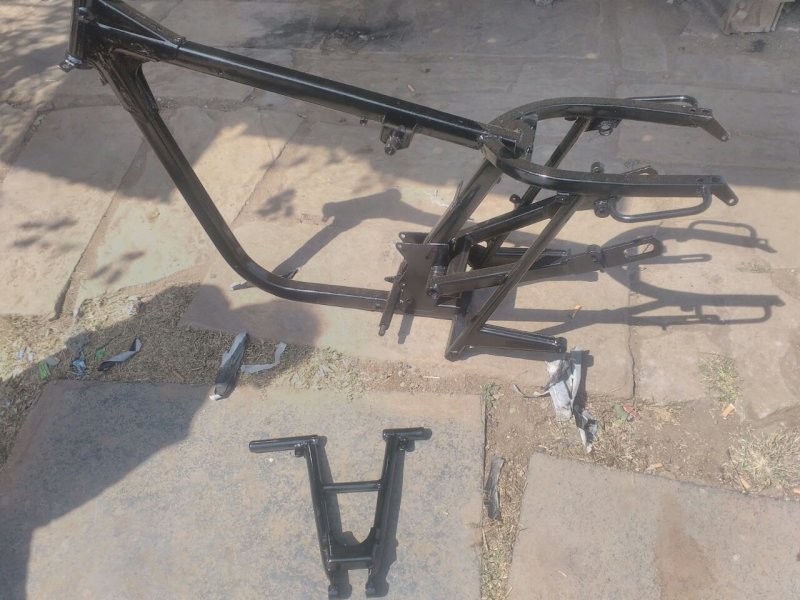

Restoration started at: October 16 2016
Present condition given in pic. I will be posting few more pics and complete cost break up after complete restoration.
