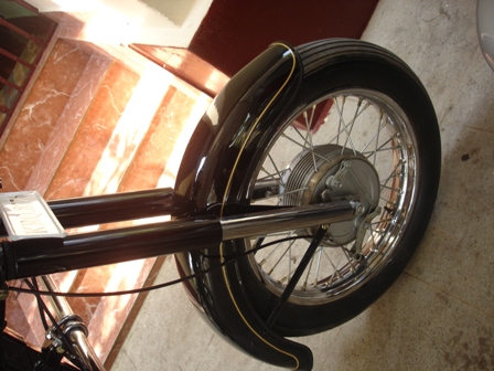

hi all, thank you for your work and support. been very busy nowadays, resulting in delay in posting.
Now work is over Yezdi is out running fine [clap]. Since engine work has been done i have been riding it below 60km. I ll post pics. Ride experience handling will post separate .
New speedometer [;)]
