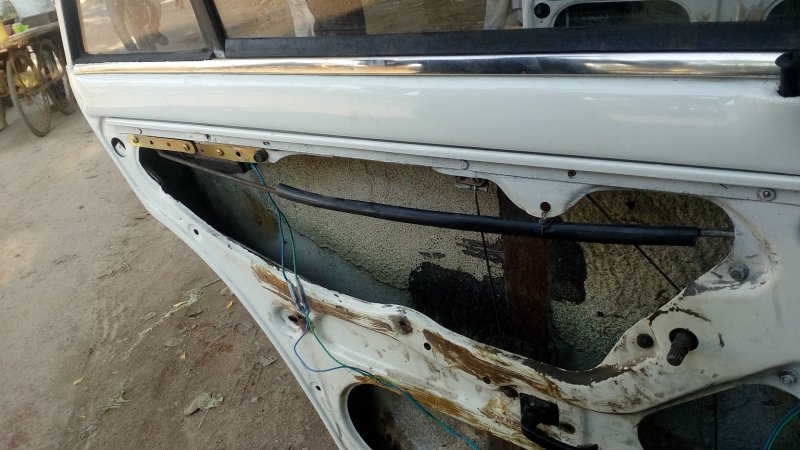

*I was not comfortable with manual lock - unlock of door locks each time.so for getting rid of this problem installed xenos rottweiler central lock kit.
*REAR DOOR CENTRAL LOCKING SETUP-
