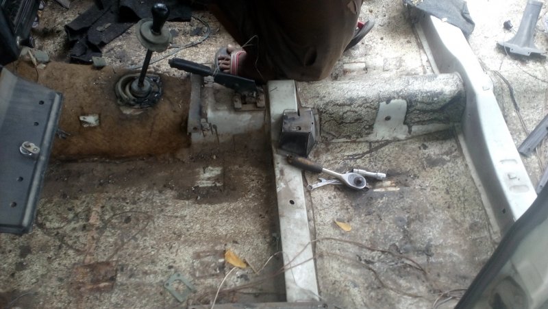

Interior
As i said earlier car was standing in the shade,thats why we didn't get any surprises in interior,though rust was there,on floor,on rain channel ,on dashboard lid hinge,etc. but nothing that was a big issue to us. Rust will be treated once painting started,but as of precaution,we cleaned the floor and applied black paint on it.For this process we take out interior original mat.which was in many pieces as supplied by company.Was damage in some areas too.But my bad that i didn't take pics of that before taking it out[frustration].now we are unable to identify which part goes in where.

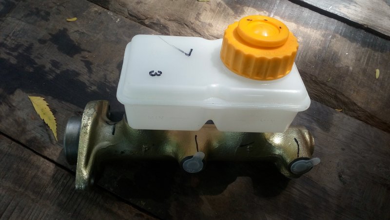

First priority was to get the brakes overhauled following parts needed to be changed-
Brake master cyllinder major kit
Bleeding nipple
Brake hoses
Brake pads
Brake liners
So the hunt starts and after hunting almost one month i couldn't spot a single major kit for master brake cyllinder although minor kits were available.but they were of no use.So i bought a brand new master cyllinder from delhi.Could n't find bleeding nipples still so using old nipples by cleaning them .Brake hose were also not available ,so reconditioned them with new hose pipes and metal jackets around them.Brake pads were arranged KBX make but later found out that NE comes with two types of brake systems and these KBX make brake pads were not suitable for my car.So had to buy suitable one.LUckily those were available of a brand called AMT ,i did not have many choices to chose so bought these.Brake liners are old still ,did not changed them yet.
Old master brake cyllinder

New master cyllinder

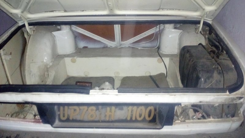

Bought alto tail gate weatherstrip and fixed in front bonnet weatherstrip area and in boot too,rattling noise from both areas are gone now,although will have to bought one more weatherstrip as one was not enough for bonnet and boot and in boot some area was left.

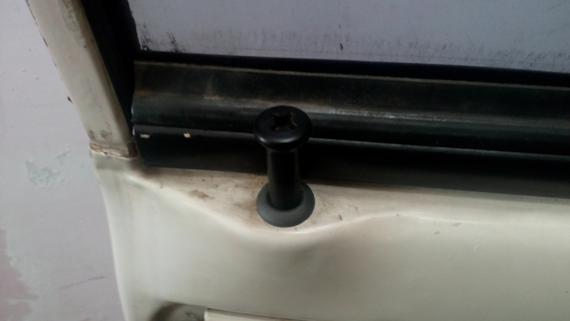

7)Left side rear door is not locking from inside lock knob,also it is not shutting completely.W hen shutting door there are two steps in first step door shuts and in second step door locks ,in my car only first step is completing.When i shut this door it comes back it is not locking up completely.
3. Balancer rod bush from other cars will fit in the NE. Just take a bush to a shop that sell parts for cars.
6. You can weld a small piece of rod and extend the link as much as desired.
7. If you are not able to depress the locking knob completely, open the door panel and locate the Horizontal rod (not the vertical one on which the knob is mounted) that connects the latch and pull it downwards to bend it as much as you can. This way the length of this rod is shortened and the knob can lock properly. For the door, remove the rubber beading and check if the door shuts close till the second step. If so, you will only need to adjust the door catch unit slightly and you are done.
