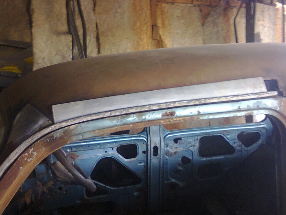

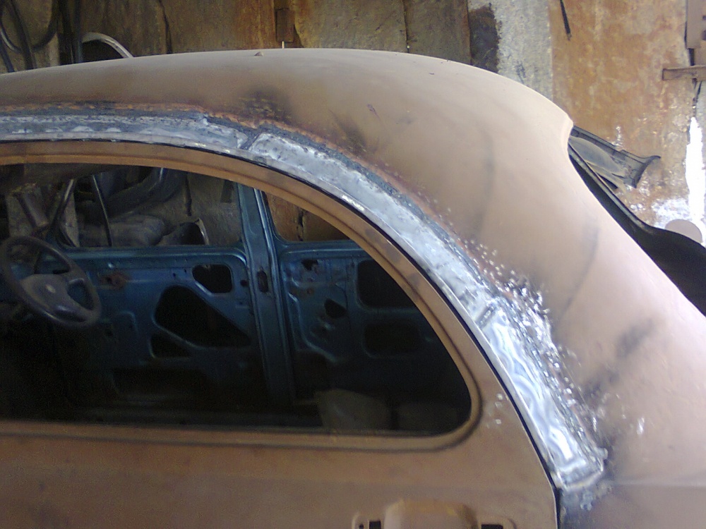

sorry i was busy in my work so i could not update regularly, work is in progress and almost 80% of tinkering work is done, so i will post the images soon

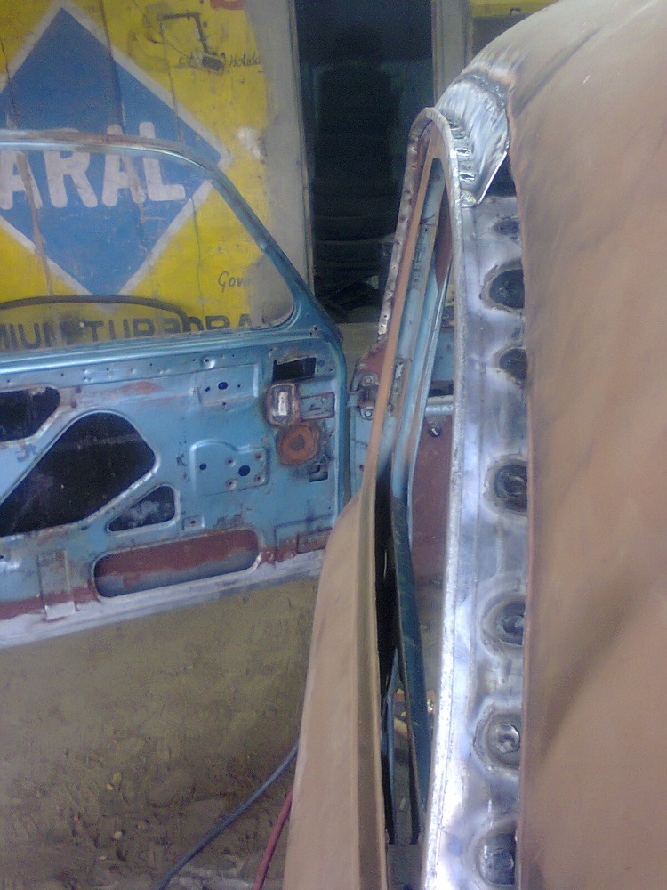

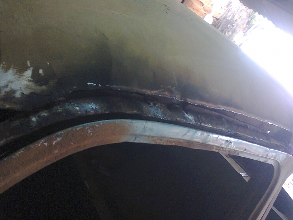

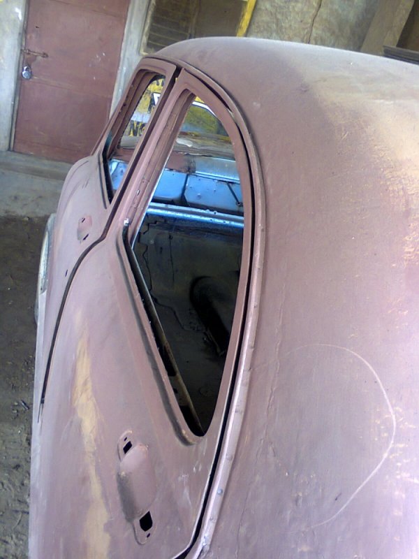

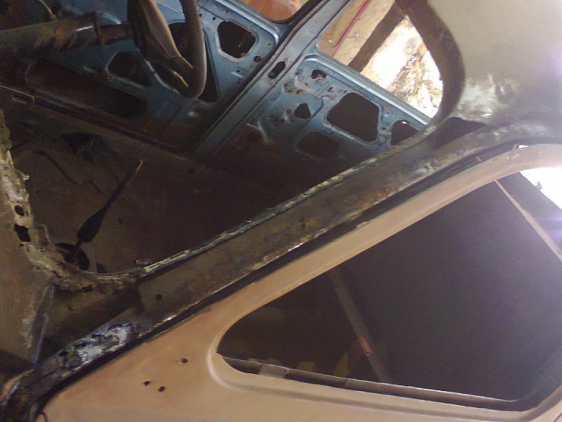

pics continued... the glass pole was rebuilded both sides so the main process was to equip front glass to check the fitting and alignment

Wow ! That is some extensive tinkering work. Hats off to your tinker. Kindly make sure there is not even a single inch of corrosion in the body before start to paint. do a complete detailed inspection and dont get compramised from the tinkers word.

Nice work done.
Paste work need to done perfectly to make that Amby body lines maintained properly. I hope your Tinker is capable of doing that easily.
Finally it depends always with the Painters who do the final paste work after tinker has done his part.
sure i will do complete inspection, i wont compromise on that part of work
