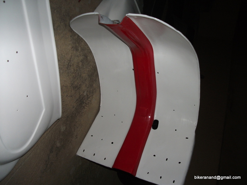

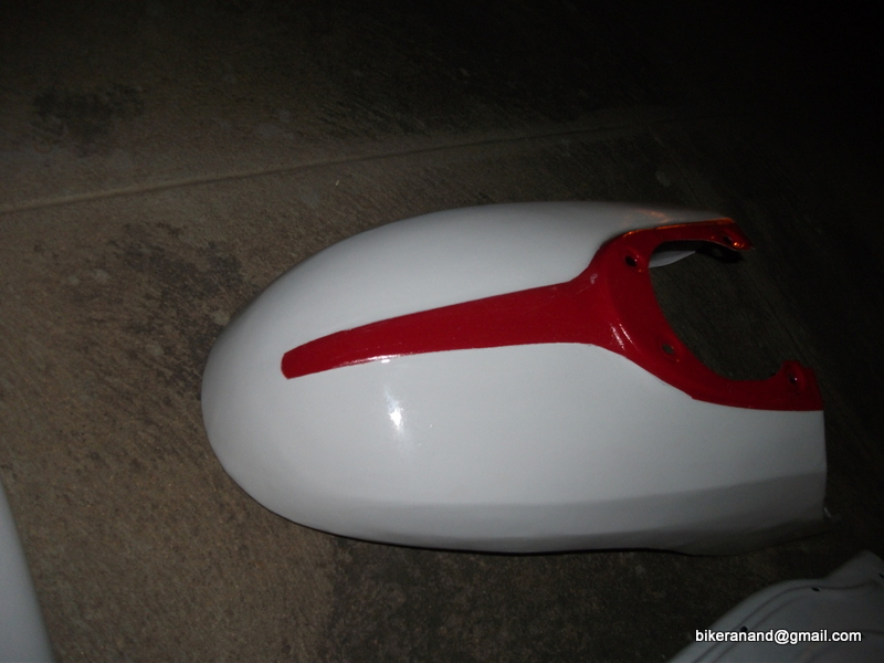

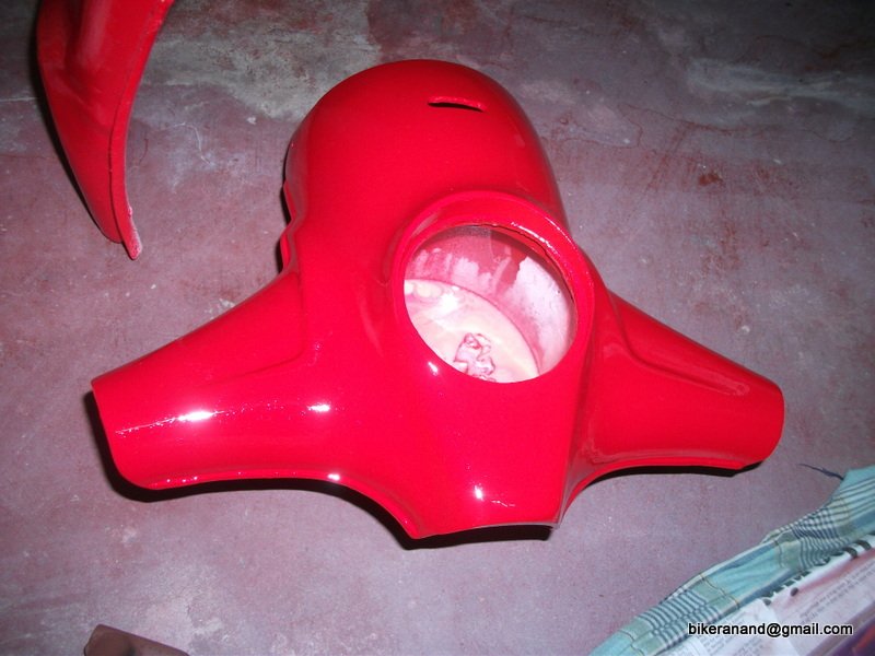

We have completed the Red portions yesterday, here are some pics.

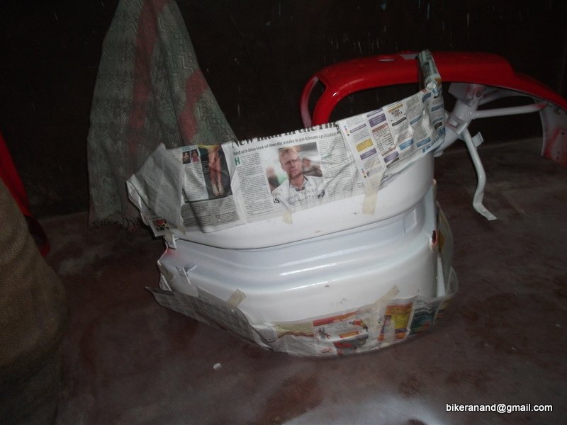

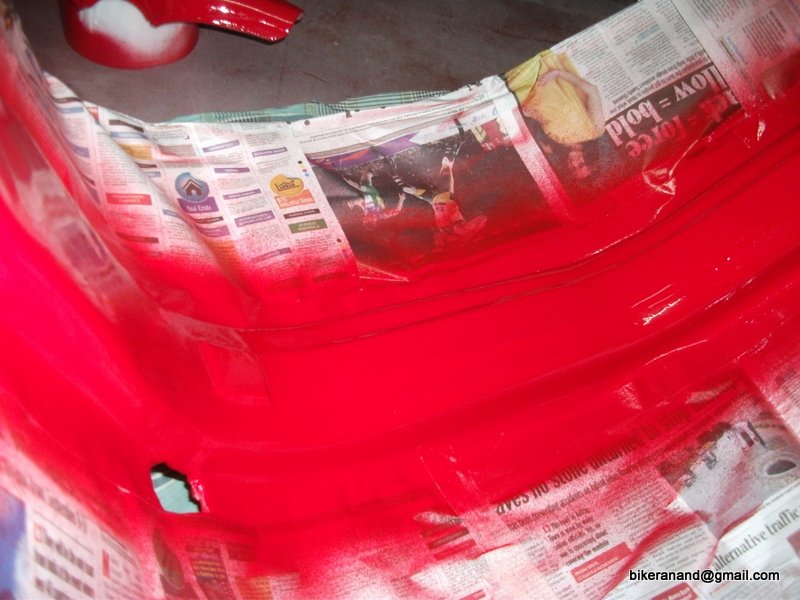

We have made a pattern (kind of red stripe in the middle of innerside) so to do that we have to mask the white areas & paint it red
You can see in this pic below the difference in colour of the Nose & the chassy. The reason why this happens is
1. Nose had only primer, no base coat (white colour) was applied so this red is much darker.
2. The chassy has Primer & on top of it we had the Base White paint & then we painted it red, so this red is much brighter
We had to redo the Nose to match the Colour on the Chassy & head

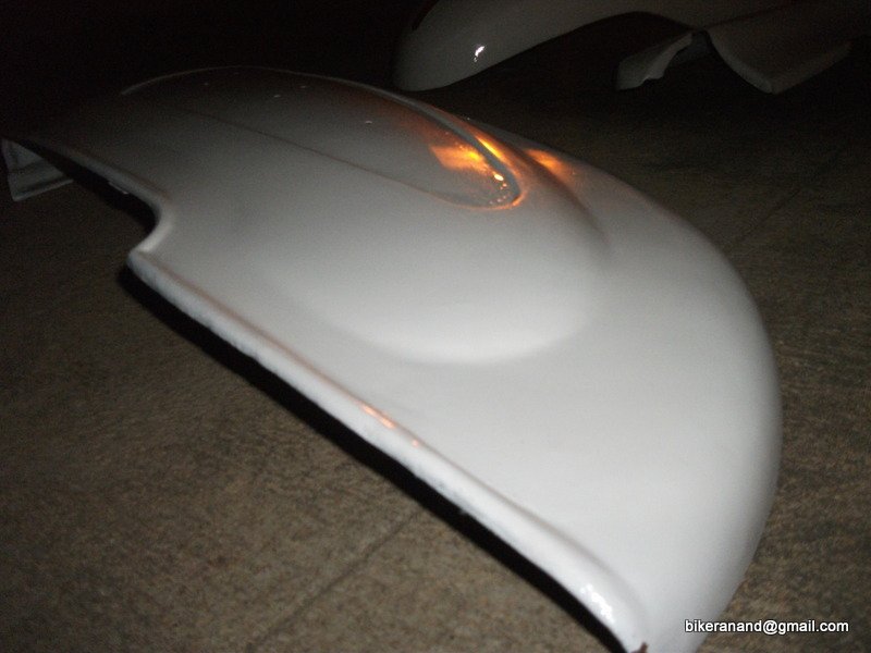

Thanks again Everyone,
Painting work is done & ready to be fit on chassis. Fitting might take sometime as it will be done at my friend's garage. New tyres, engine parts, cables etc will also be fit in a fortnight's time. Tomorrow all these items will be taken in a Palio to my friends garage, where the front windshield & floor board etc will be fit.
Here are the pictures after rubbing compound was applied.
