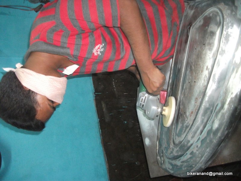

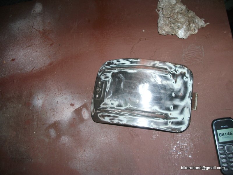

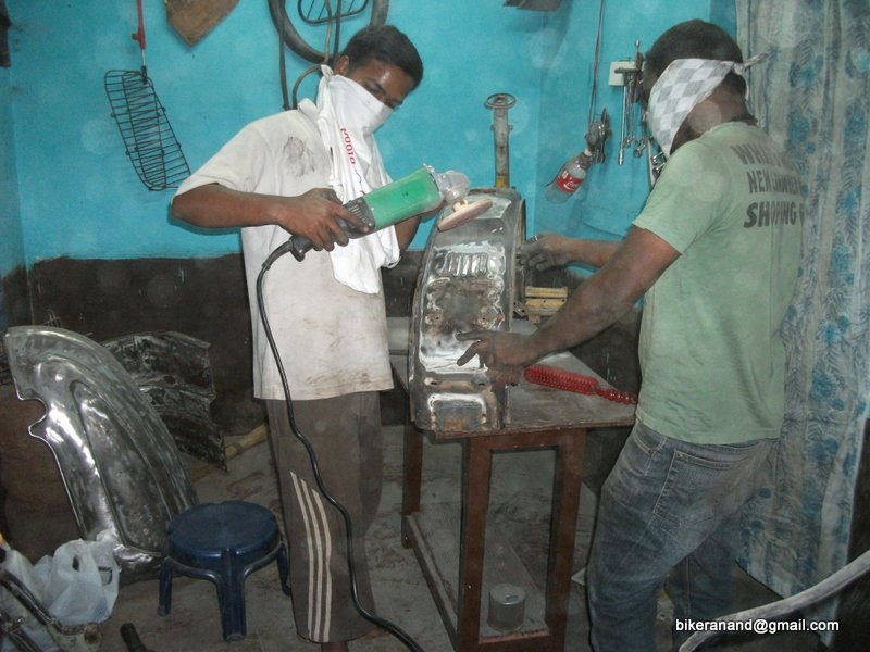

Sorry guys for the late update. Here is the progress till now.
I purchased a Sander cum polisher machine for 2.5K & started off sanding all the old body work, then wiped them with thinner, sprayed Oil based Auto Primer (used petrol to dilute it) & then the first coat of N.C.Paint (White colour). The finishing was not up to our expectations so we applied N.C.Putty & sanded them to smoothen & give an even surface, but we applied too much and the output was again below our expectations. We will sand the side shields, front body work & nose etc and do a better primer + putty + base paint + Final Coat+ Clear coat work. We have spent a lot of time, doing this all these days. We badly needed a break so did not touch it for today, will start again by tomorrow evening.
Pictures will do the talking now
Sanding process
The above pictures are 90% sanded parts, edges & corners need sanding using hand + sand paper + wooden block.

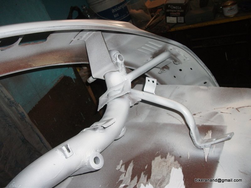

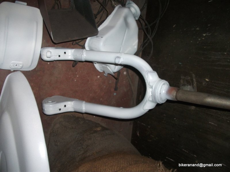

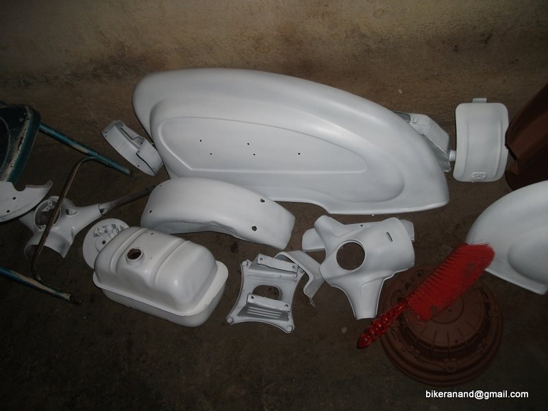

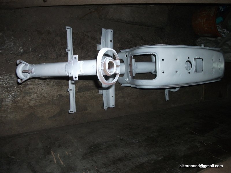

The oil based auto primer
Primer applied to all parts [:)]
