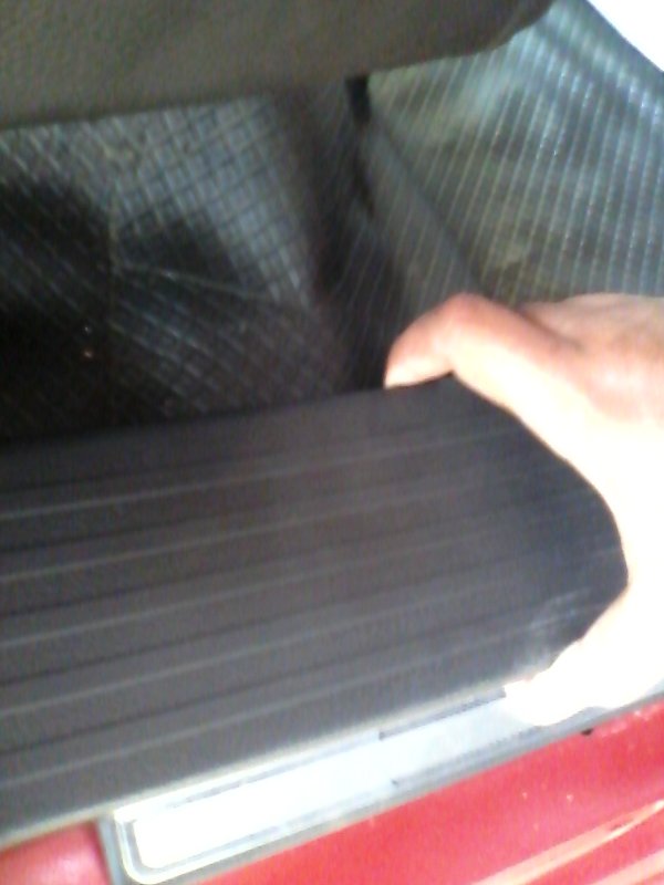

guys, an another DIY
premium carpet flooring.
stingray had an old styling rexin flooring
it use to be more cheap looking
so prepared to do a DIY
i used an
SYNTHETIC FIBER CARPET
Sq.ft. 25Rs
Things needed:
carpet as you needed
screwdriver set
scissors(big size)
you can just cut a approximate size and place it ,but finish would int be the best looking
so i removed all plastic interior coverings to place edges and sides of carpet inside panels so it feels premium
i used a news paper for getting rough shape
then transferred to carpet
then i trimmed the edges after placing inside car for exact fit
then i fitted the panels back.
this is how it looks before and after
FINISHING IS THE IMPORTANT ASPECT
SO BE SURE BEFORE CUTTING ANY EDGES!!!
