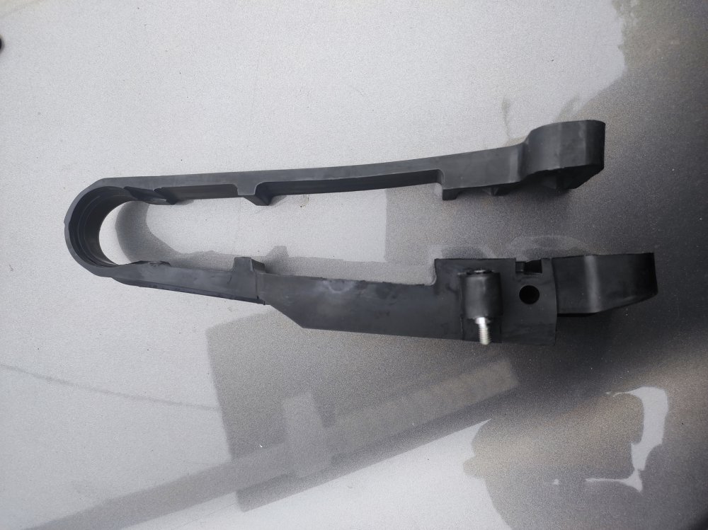

New slider vs remnants of old.

Chain Slider - JG122036₹ - 243.00
Ooh, you were lucky and got the right part. I wasn't so lucky though and got a newer part
The bolt will hit the rear set and can't be removed.
For this reason I never put it back [gun]I just removed the sprocket cover, front sprocket and swapped out the slider
I don't dare to miss out any bolts on the vibrators [lol]
The design seems entirely different, how'd you secure it? Does it stay in place without any trouble?
Sep 24, 2022
21
42
The swingarm already had holes for the newer slider. BUT they were filled with 9 years of sand mud and chain lube. Cleaning them out, tapping them was a MAJOR PITA. I'll never do it again.
Furthermore, the bottom bolt holding the slider fell off. I had to take off the front sprocket, move the chain and fix back a new bolt for it. Because I didnt have the right bush for this slider, I couldnt tighten it all the way in, thus it fell off. Had to do some jugaad with washers to get the right height then slathered a ton of threadlock so it wont fall off again
Red = stock hole, blue = new hole

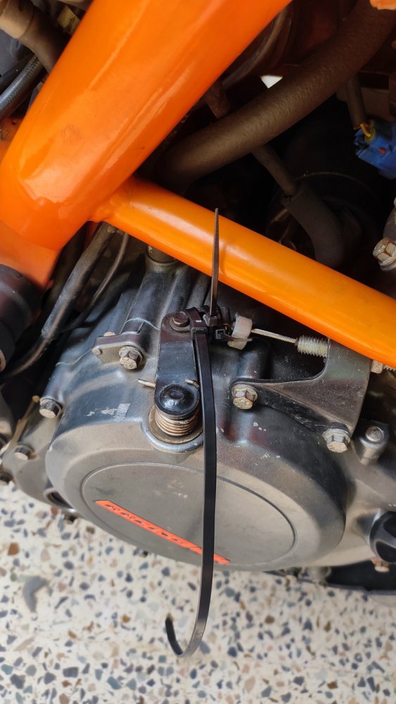

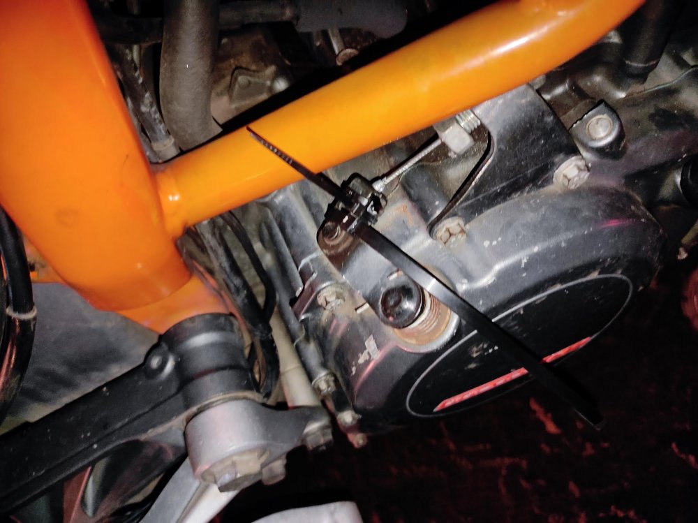

Last night's job. How wire ties can save you.
How it got split.
