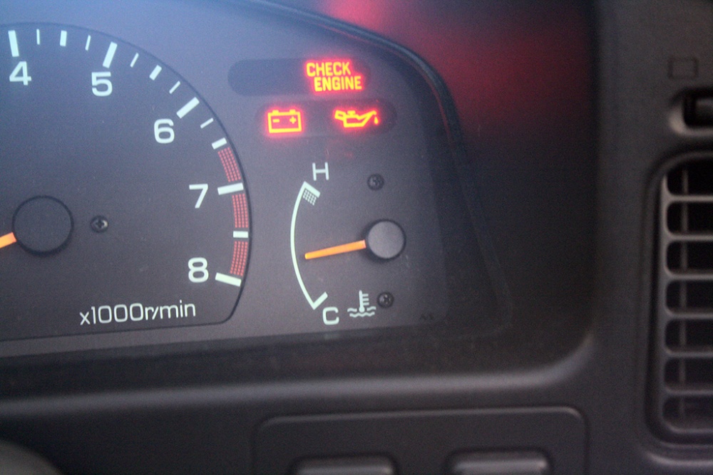

Step 1: Warm up your car, just do a quick drive around your neighbourhood to warm it up, or just let it idle. But not for too long, the temp gauge should be midway between cold and hot.

Warm oil drains out much easier compared to cold oil. So to let out as much old oil as possible, just bring the car to its normal driving temperature.
