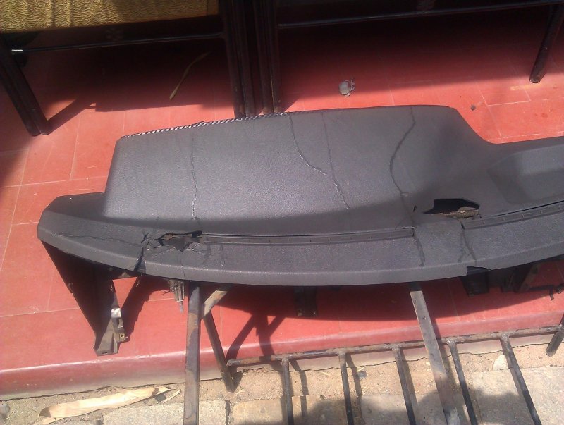

Could you give me more details of how you repaired the dash with carbon fibre. actually i wanted to put carbon fibre on my indica vista dashboard(got faded due to sunlight exposure) but the car accessories guy was reluctant saying its better for car exteriors mainly.
Hi Kenlitting,
The Carbon Fiber that your Car accessories guy is talking about is just a Stick on Vinyl that has the Carbon Fiber Effect embossed on it.
It is only useful for cosmetic and aesthetic purpose.
It might work in your case as you only want to wrap the dashboard to enhance its look.
Remember to use 3M Primer 94 Adhesive Promoter to make sure the vinyl sticks to the Dashboard well and stays stuck for a few years.
I have used a German Vinyl on my Bonnet as you can see from the photos. This was done almost 4 years back and is still looking good.
I also used the Japanese 3M Di-NOC carbon Fiber Vinyl on the Dashboard Facia surrounding the Speedometer Cluster.
Di-Noc Carbon Fibre Vinyl, Range of Colours! - Amazing Prices, Fast Delivery - Carbon Mods
This vinyl is of no use when you have to repair a cracked dash like I had to.
In my case I had to use actual Carbon Fiber to recreate my Dashboard as it had fully cracked.
See the photos for the procedure involved. It is a bit messy, but I managed to do it myself at home.
You can also check out the link Carbon fibre skinning kit - cover / wrap your own parts in carbon fiber - Carbon Mods and see the demo video there.
Hope this clears up your doubt.
